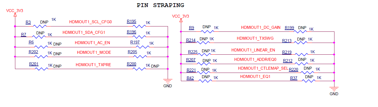

I am using TMDS1204 redriver in my HDMI design, i am facing a issue while i source 4K 60fps resolution there is a green line appearing at the left side of the screen. But not when i source 4K 30fps
Is there any thing i have to do in pin strap to remove this or enhance the driver so that it can clear the jitter if any.
I have attached the image of the issue and pin strap setting in my design.
