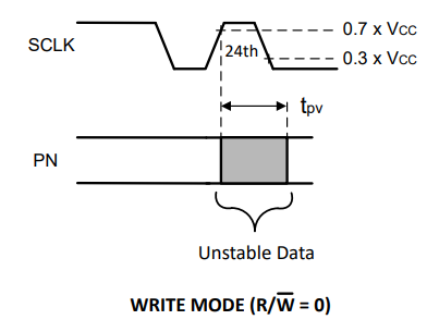

1. When is the timing at  the GPIO is actually set to output? Is it after CS becomes negate and SCLK passes tpv?

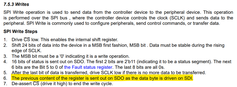

2. Does the following mean the written value can be output via SDO? (Is readback operation possible?)
3. In the case of the operation described in No. 2., when the value readback value is different from the written value, can the controller rewrite it?
    When the 24th rising clock edge occurs and after a tPV, the Px.x pin is set to the appropriate output voltage.
    Step 6 shifts out the previous register setting on SDO while a byte is being driven onto SDI.
    For example, if the output port register already reads 0xAA, and you want to change the byte to 0xFF. As you write 0xFF on SDI, you will read back 0xAA (the previous registers' contents).
    The readback value is the previous register value. The written value and the readback register value are only the same if they are the same to begin with. I.e. register reads 0xFF, you write 0xFF to SDI.
