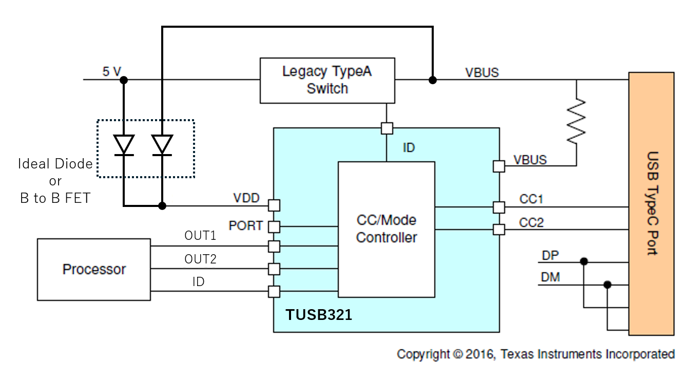

I'm considering the USB-C interface circuit as DRP using TUSB321AI.
This circuit is configured to support DRP (Dual-Role Power) mode.
However, we want the circuit to be powered solely by the host's VBUS when the TUSB321 functions as a device.
Therefore, as shown in the attached block diagram, we believe that the VDD of the TUSB321 should be supplied from two sources—VBUS and another onboard power supply—using two ideal diode or back-to-back FETs.
In this case, what is the recommended way to connect the VDD pin of this IC to the power supply?blockdiagram.png
    I would recommend looking at how the TUSB320EVM provides power to the TUSB320. It has the option to be powered from either a type-C, Micro-B, or external power supply. This EVM can also be used with the TUSB321, so the way the power is routed on this EVM should also be applicable to this application.
