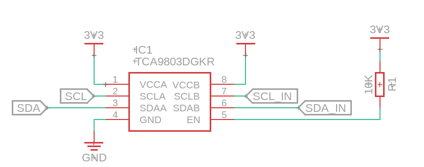

Dear experts,

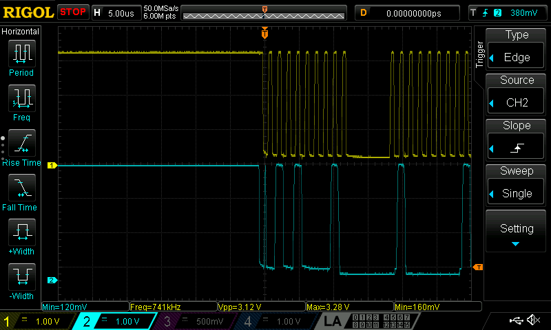

We're experiencing an issue where the logic low voltage of the first bit isn't low enough. This results in the PN7160 not being able to recover after reading invalid memory. The bus seems to remain operational, but operating out of spec for the PN7160.
The measurements below are done at the B-side at the end of a 50cm ribbon-cable. There are 2K2 pull-ups on the A-side and none on the B-side. We've tested this with TCA9803, TCA9802 and TCA9801. Measurements below are with TCA9801.
DS1Z_QuickPrint52.pngSession 1.zip
Attached is also a capture performed with Logic 2 (Saleae). The out-of-bounds memory read happens at 10.509322 seconds.
Could you help us find a solution?
Jochem

  • Hi Jochem,
    CH2 is the output of the buffer after the long cable.
    I am thinking that the 50cm cabling has some series resistance drop that is affecting the VOL at the PN1760. What is this voltage drop?
    VOLB(max) = 0.26V. Given the VIL requirements at the PN1760 chip
    It looks like there should be at least 0.99 V of margin for VILB.
    Are you saying these first few bits are above this margin?
    I am not completely sure why there is higher VOL on SDA.
    When I compare to SCL, the clock waveform looks fine. VOL looks consistent across clock cycles. SDA starts off with higher VOL and then settles to a lower VOL.
    Is there any differences between the two traces?
    Tyler
  • Hi Tyler,
    The cause has been found. The 13.56MHz from the NFC-scanner is injected into the I2C-bus. We oversaw that the SCL and SDA lines are now in hi-Z after switching from pull-up to current-source. This is almost certainly the cause of the described behaviour. We're happy that we finally understand what's going wrong, but now we still need to fix it. Note that the horrid sight below is only the case with field active when tag is present.
    We were under the assumption that using an I2C buffer was going to increase robustness, not make it more sensitive to external factors. That begs the question, what next? What do you recommend?
