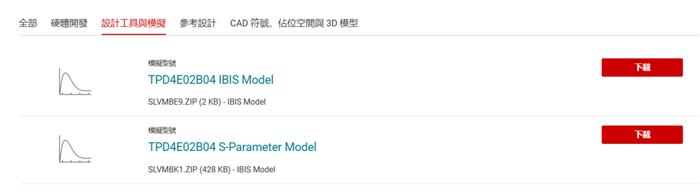

Part Number: TPD4E02B04-Q1
HI TI Expert,
About the TPD4E02B04-Q1,
May I know whether the S-Parameter model we provide on ti.com can also reflect the performance across TA from -40oC~+85oC?
Thank you.

Hi Evan,
The S-parameter model is only done at room temperature. There should be a way to simulate across temperature in ADS with using the s2p file.
McKenzie
Hi Evan,
We have a S4P file for this device. The file is attached below.
McKenzie
