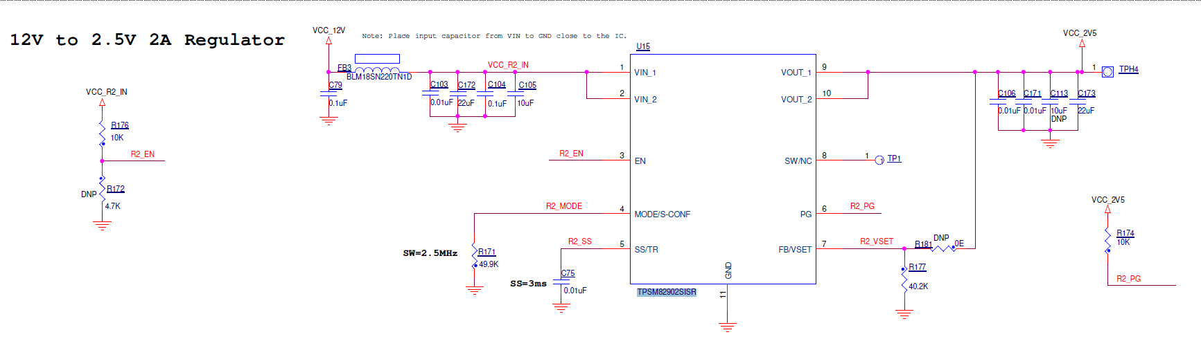

I have attached TPSM82902SISR schematic for review.
Could you please check and provide your feedback.
The output voltage selected is 2.5V

Hi Irfan,
Schematic seems fine and for 3ms soft start please keep 12nF Capacitor at SS pin.
