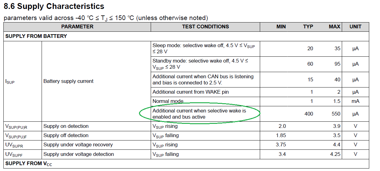

   The following figure is from the TCAN114x datasheet:
I use a DC power supply to output 12V to VSUP while displaying the current value.
I set the MODE_CNTRL to 0x01 that is Sleep mode and selective wake is disable, but the current value measured from VSUP is approximately 400uA, not the TYP 25uA shown in the above figure.  What's the reason?
