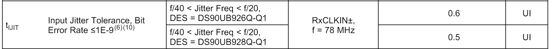

    In my project, I use the DS90UB927&928,for lvds singal transmission,To adress EMCissues,I add clock spreading to the LVDS clock output from the CPU to 927,with a spreading frequency of 31.5khz and a downward spread of 0.5%.but ,we observed screen flickering.if we disable the clock spreading effectively resolved the issue
    I noticed in the datasheet that the eye diagram test conditon  is: jitter frequency>f/40,I want to know about :
1/why we need such frequency;
2/cloud low-frequency power noise or thermal noise cause the CDR lose lock,just like the clock spreading cause
Bruce

    And i still have some questions regarding jitter frequency and hope to get your answers:
    1.In the 927 datasheet mentioned:the jitter frequency is specified in conjunction with 928 PLL bandwidth,i want to understand the connection between them,because in the specifications the jitter frequency is defined as a  range (fpclk/40<f<fpclk/20),while in my understanding,the PLL bandwidth is a boundary,a specific value.Dose tihs frequency range exhibit a peak in gitter gain,making it the most vulnerable part of the CDR?
    2.I have observed that when clock spreading(SSC) is active and the CDR loses lock, the LOCK pin is pulled down and then quickly pulled up again(several microseconds),but this status is not recorded in the 0x1c register. Is this behavior expected?
    The 927/928 has a specific frequency range because there are frequencies that will be rejected by the FPD TX PLL and others that will be passed along onto the serialized stream. The range of f/40 - f/20 is what has been validated.
    Yes this behavior is expected. The LOCK pin reflects instantaneous CDR lock status and can toggle during very short transient events (µs-level) such as those introduced by SSC. The 0x1C register is filtered and requires the unlock condition to be present for longer duration to be recorded so brief LOCK drops may not be latched
