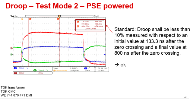

    We have a critical request regarding the DP83TD510E-PODL-EVM performance:
    We are using the Wurth 74930200 (350µH) transformer in our design, which matches the BOM of the TI EVM. However, we are seeing a marginal failure in the Test Mode 2 (2.4Vpp) Droop Test (we measured ~10.26% droop, which exceeds the 10% limit of IEEE 802.3cg).
    Could you please confirm if the DP83TD510E-PODL-EVM actually passes the Test Mode 2 Droop Test (<10%) in your lab?
    Since 350µH is physically marginal for the 2.4Vpp low-frequency requirement, we suspect the EVM might also be on the borderline or relies on the newer IEEE 802.3dd (25%) limit. Knowing the EVM's actual test result will help us decide whether we must change the transformer or simply update our test standard limits.

  • Hi Allen,
    Currently, our compliance scope is send out for calibration. We only have the some scope capture on the voltage droop. It seems like we are above 10% within 133.3ns when in the PoDL board when we power externally.
    We will provide you an more detail update when we receive back the scope next week.

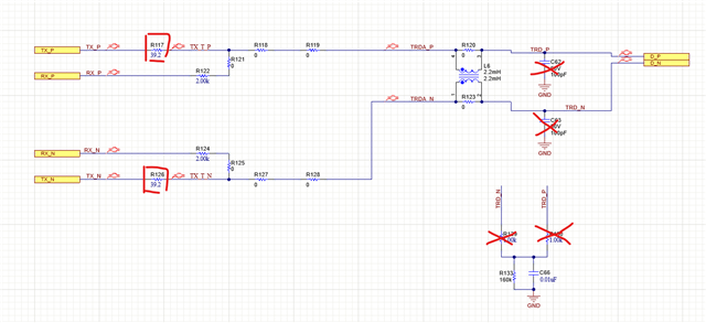

    We did some initial study on the voltage droop performance. Could we start with changing some parameter on your side to see if that improve the PoDL performance?
    • Make sure the R117 and R126 are 39 ohms.
    • Remove common mode termination R129 and R130
    • Remove capacitors on the MDI lines to ground.
    Hillman Lin
