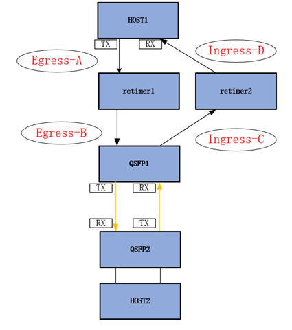

  • Hi Drew,
    Note that the eye diagram on our Ingress-C side is poor.
