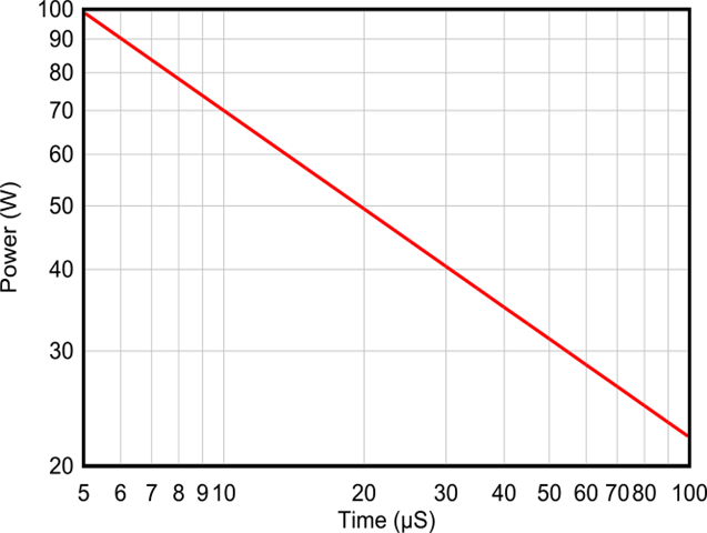

For lightning protection analysis, we need the graphical representation of Peak Pulse Power (watts) vs Pulse width (microseconds) graph for 5 and 20 microseconds which is not available in the datasheet.

Hi Aravind,
I will be working on getting the requested graphs and will follow up at the beginning of next week.

Hi Aravind,
Please see attached.
