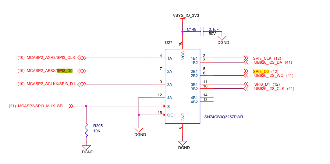

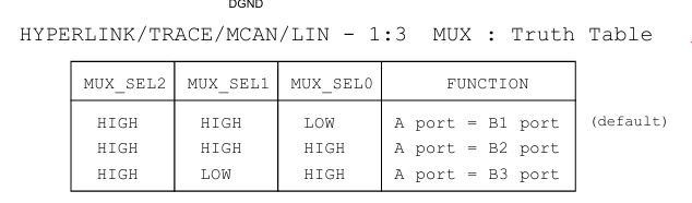

  • Hello Alice,
    If you short D0 and D1 you will receive the same data sent and acts as external loop back method.
    This MUX SEL0 port pin is hardware connected to switch as well please check the schematics.
    Which SDK version is this?
    Tarun Mukesh

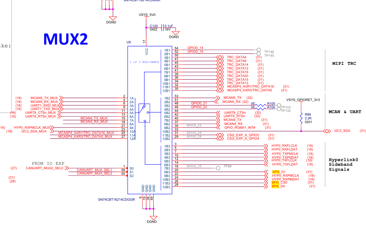

    2. I couldn't find a switch to connect to, so I added an IO expander setting in McspiApp_Startup.c.
    3. ti-processor-sdk-rtos-j721s2-evm-10_01_00_04

  • Hello Alice,
    First of all ,Happy new year.
    1. Because I can match rx and tx data with and without shorting, which is different from what I originally thought. Do you mean that shorting it results in an external loopback, and not shorting it results in an internal loopback? And do both external and internal loopbacks successfully transmit data?
    Let me give more detailed explanation,
    External Loop back:
    Consider D0 as Tranmission and D1 as Reception , D0 and D1 should be shorted so that you can get the same exact data send to received buffers.
    Internal Loop back:
    Consider D0 as Transmission and also as Reception then without any external shorting the D0 data sent will also be received into receive buffers.
    Yes, sorry i checked for other device J784S4 . For J721S2 there is no switch
    For example to control IO expander we will do as below in screen shot to drive.
    This is only sample screen shot to drive IO expander not same should be used.

    Additionally, according to the circuit diagram, to send a signal, the TCA6408ARGTR's MUX needs to be set to B3 port, so I also changed the I2C configuration as follows.

    However, the TX transmission and RX reception data are still mismatched. Is there something wrong with the settings?

    I have checked your code regarding PIN MUX for me on top level it looks good but I can suggest you the easiest steps to debug.
    1) Are you able to see clock at required frequency ? If not measure please take an logic analyser or oscilloscope to see the clock.
    2) Are you seeing data on Tx and Rx pins ? if not do the same as i mentioned in step 1
    If you are able to see clock properly then your TCA6408ARGTR's MUX is correct if not it is not correct still. If clk is correct then we can confirm your MUX configuration is good.
    Tarun Mukesh
