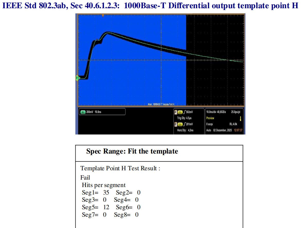

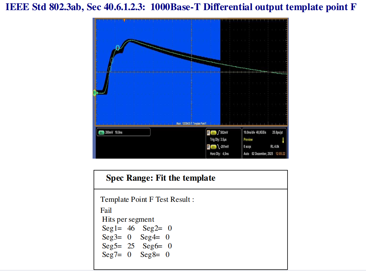

1. We are failing the Template test in two points (F and H).

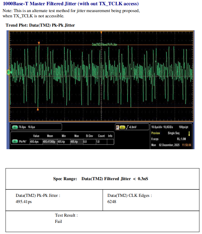

2. We also are failing the Master Filtered Jitter by around 200 ps

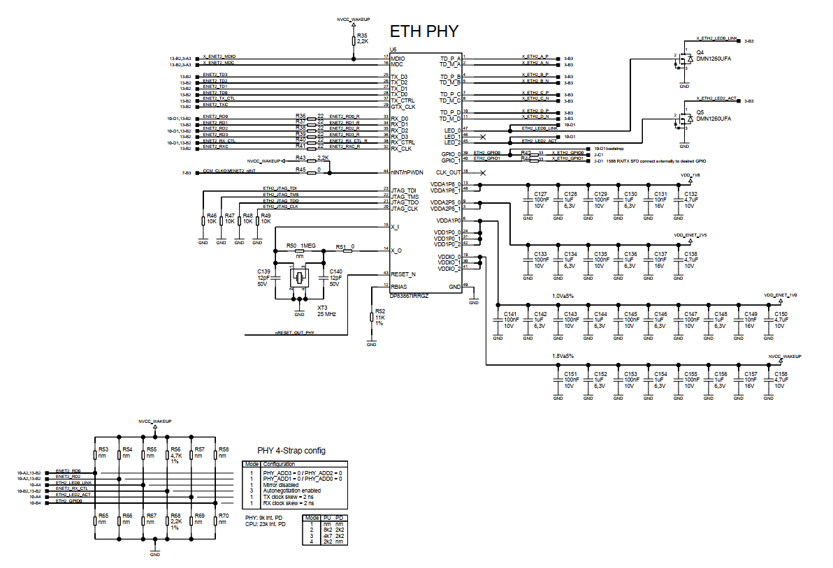

The schematics in this design are taken over from our known-good designs.

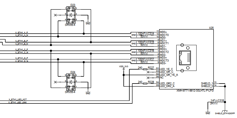

2. ...changing values of center taps

4. After that we tried adjusting the Rbias from 11K to 10K. This resulted in passing the Template test completely (including points F and H).
However the Jitter Issue is still unaffected.

    2. The performance of the PHY will not be affected for changing RBIAS from 11k to 10k and this is actually one of workarounds for some of the compliance test failures (distortion test) that we suggest. However, other parts of the compliance test may be affected due to the change in the RBIAS value.
    For jitter issue, I would check if the crystal is within our recommendation. This test usually fails because the crystal exceeds the ppm requirement.

    Thank you for your answere. We passed the complete compliance test (with the ecxeption of the Master Filterd Jitter) with a 10K Rbias equiped, so we will continue to use it.
    On paper the crystal seems to fit the requirements of the PHY. After your suggestion we started further investigations on the cryctal, that are still running.
    Greetings,
    FD
  • Hi Felix,
    As previously mentioned, there should be no issue with using 10k for RBIAS.
    If crystal is giving out more noise than expected, this can cause the PHY to give out additional jitter causing the failure of master filter jitter test. Please keep me updated.
