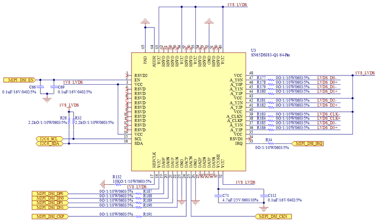

Please help SN65DSI83TPAPRQ1 circuit diagram confirmation

Hi Kevin,
Thank you for sharing the schematic for this. The only feedback I had was:
1. Please check the "9.1 VCC Power Supply" section of the datasheet where it is recommended to add one capacitor at each VCC pin. Is this included in the full schematic on the VCC pins?
2. 1uF capacitor on VCORE should be sufficient
3. For the LVDS outputs, please check whether the receiver/display has 100 Ohm differential termination. If it does not have 100-Ohm differential termination, then external resistors should be added.
Please let us know if there are any further questions about the device.
