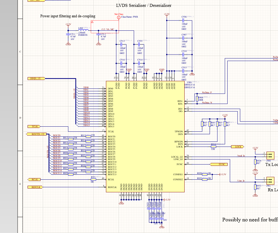

Find that the device will not behave properly until it has had 'reset' of 2 or 3 seconds of innactivity on inputs following power up. Thereafter the device behave  normally achieving lock and maintaining datalink to another device
  • Hi Chris,
    Can you describe the behavior of the device that is improper? How were you trying to use the device after you applied power, and how long had Vcc been above 2.2V once you tried to use the device?
    Matt
  • Hi Matt Thanks for responding
    in answer to your question, the devices parallel side is attached to and FPGA which doesnt get configured and start driving the device till several seconds after power up. 3.3vpower up behaviour is normal.
    By improper behavior i mean it does not achieve lock with another device at the end of the serial link. We have a 'tried and tested' protocol driving the SYNC till the LOCK is achieved at the receiver. We have used this device for over ten years in multiple designs. this is the first time i have seen this issue.
    The device seems to get itself in this 'locked up state' at power up no amount of FPGA reconfiguration cures it. The device deosnt have an external reset line but i found by experimentation that by holding the TCLK,DIN,REFCLK lines to the device static, this forces a kind of reset. Thereafter the device  locks up as normal with another device without any issues. FYI The DEN,REN are pull up permanently active and the PWRDN pins are pulled innactive.
    My investigations are on going, I just posted to the forum to see if anyone else had seen similar behaviour, or maybe an original designer may have an idea
    I am confident about the general PCB layout and decoupling etc as this is a much used device for us.

  • Hi Chris,
    So to make sure I'm understanding youre use case correctly, you are driving the SYNC pin high on the downstream serializer to generate the sync-pattern that consists of 8-bits of data high followed by 8-bits of data low for the deserializer in question to lock to. Is that correct?
    If so, does the /LOCK pin ever go low temporarily, or does it always stay high? Are you able to confirm that the downstream serializer is outputting the expected sync-pattern?
    Also, can you try the following power up sequence if you aren't already: Power up all VDD pins together, apply clocks (RefCLK & TCLK), and then bring /PWDN powerdown pins high to enable the transmit and/or receive channels.
    If you could share a schematic of how these devices are connected, that would be helpful.
    Matt

    Schematic attached..  we have 12 of these on one board (0,1,2,3,4,5,6,7,8,910,11).
    My test mode link uses SFP serial cables to link serial tx 0 to serial rx1 and viceversa, 2to3, 4to5 etc..
