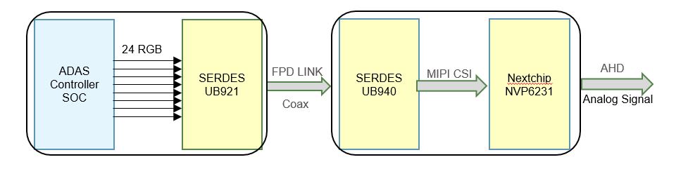

Hello TI team:
We have an project about ADAS 360 Surrounding Video out, the customer Video interface is used AHD. So we make a signal transimation solution and hardware architecture as below:
Serializer: choose UB921, RGB input, FPD LINK III ouput, Coax
Deserializer: Choose UB940, Coax FPD link III input, MIPI CSI output
Could you help to double check the feasibility for this Serdes solution(UB921 with UB940). Any issue for this architecture? Thanks a lot.
