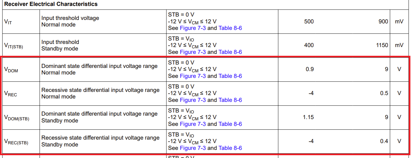

Below table is about differential input voltage range in case of normal/standby and dominant/recessive mode.
But end customer's specification is little different.
Vdom -> min 0.9V, max 8.0V (datasheet shows 9.0V)
Vrec -> min -3V (datasheet shows -4V), max 0.5V
Vdom_stb -> min 1.15V max 8.0V (datasheet shows 9.0V)
Vrec_stb -> min -3V (datasheet shows -4V), max 0.4V
In conclusion, max voltage of Vdom and min voltage of Vrec ard exceeded compared to end customer's specification.
What would be happened if these specicications are exceeded? Can TI guarantee these specifications are not affected to device's operation?
Please check these issues. Thanks.

  • Hi Chase,
    1. CAN physical layer do not specify a fixed dv / dt as it depends on facts that are flexible for the system environment such as bus load, termination, cable, dominant current etc
    2 and 3. This should not be a transceiver parameter and would recommend checking with the controller / MCU team.
    4. See the specified VOD, receiver thresholds  (VIT, VDOM, VREC) and common mode limits.
    Note that the values are functional detection ranges and not the absolute electrical limits I.e., they describe voltage ranges that guarantee the device will interpret dominant vs recessive levels correctly and do not mean the device will be damaged or the bus cannot temporarily exceed the values. Hence, our spec includes margin in addition to OEM specs to allow for robustness.
    If OEM spec is exceeded while still within the data sheet's spec, the device will still operate as guaranteed by TI, receiver will detect dominant / recessive levels as expected without any risk and exceeding the data sheet limits would imply behavior will not be guaranteed, thanks.
    Michael.
