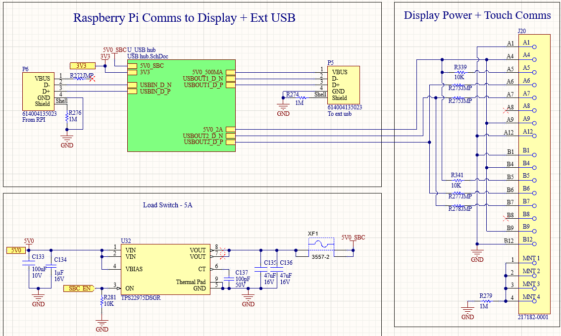

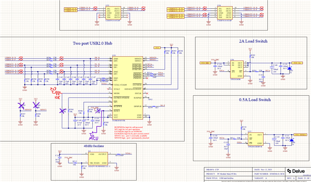

Greetings. We are using a TUSB2036 to split a single upstream port into two downstream ports on a custom PCB. The downstream ports are powered from a supply that is on the PCB. We are not seeing our TUSB2036 deassert the /PWRONx lines as we believe it should, and when we attach the hub to a machine (windows 11), windows device manager states "Port Reset Failed". Attached are two screen grabs from our schematic. Please note the following:
1) R300 and R301 are depopulated
2) We recognized that the MODE pin should be asserted to work with an external oscillator - we've re-worked the board to correct this. Functionality did not change
3) We noted that the device requires a momentary pulse on the /RESET line after power up to guarantee operation. We re-worked the board to provide this. Functionality did not change.
Any help would be appreciated, we are running out of ideas.
  • Apologies, the error is "Device Descriptor Request Failed" when connected directly to a windows 11 machine. If connected indirectly through another USB hub, the error is "Port reset failed" - but this is not a valid use case in production.
    Another note - the suspend pin is always asserted except when the reset pin is pulled low.

  • Hi Chris:
      What is your real clock connection ? 6Mhz oscillator or 48Mhz clock?
    For Reset: you need to replace R309 with 01.uf cap, and R302 should pullup to 3.3v.

  • We are using the 48MHz oscillator (and per note 2 above, even though the SCH doesn't show it, the mode pin is now asserted to specify the 48MHz clock). Per note #3 above, we did already update the reset circuitry to provide a reset pulse. Unfortunately we saw no change in performance. We've also tried resetting the part manually after initial power up (by briefly tying the reset line to ground), and the results are the same. Any thoughts?

  • Apologies for the delay. Not much is different in the schematic, I believe the text describes it well, but see below for the markups. R300, R301, R303 and R302 are not populated. The MODE pin is now pulled up to 3V3 with a 10k resistor. The /RESET line is routed out to our MCU for control over the startup reset pulse. Please let me know if you see any issues.

  • Can you try  reset  circuit below?
     Since it;s linux hub driver issue for CM4  or CM5 ., You may just buy a cheap UBS2 hub to try with CM4 or CM5  to  check if the bug is fixed  or not.
