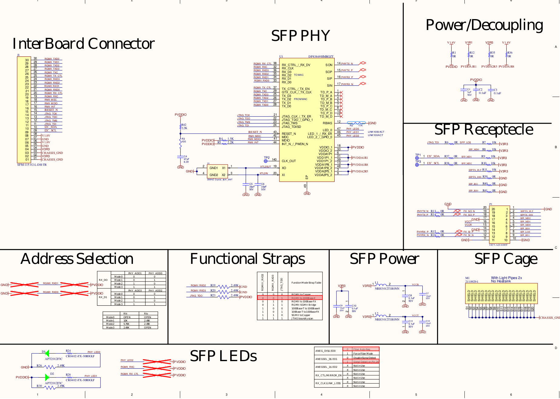

I have a custom PCB that interfaces with DP83869 fiber, it is unable to establish any communications onto the network. I have attached screenshots of the schematics. along with the device tree segment.

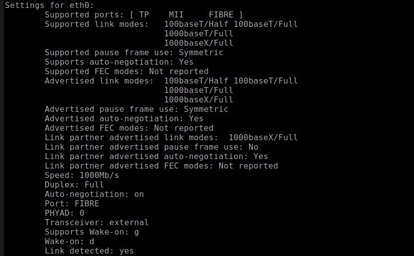

My system is able to identify the PHY and identify a carrier:
Output from ethtool:
Output from `ip a`
Output from `ifconfig eth0`

How can i establish comunications here?
    It loos like the PHY has a link and can send out packets but cannot receive packets. Typically, this is due to RGMII delay mismatch. Have you enabled TX and RX CLK delay for RGMII? Enabling and adjusting CLK delay on RGMII typically will resolve the issue. I suggest to look into register 32h to enable RX and TX CLK delay and adjust the delay parameter.
