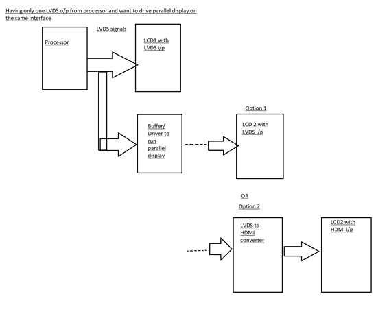

I have an processor interface, where i get direct LVDS interface for connecting LCD, which works fine with LCD
LVDS_CLK_P
LVDS_CLK_N
LVDS_D0_P
LVDS_D0_N
LVDS_D1_P
LVDS_D1_N
LVDS_D2_P
LVDS_D2_N
LVDS_D3_P
LVDS_D3_N
Now , i would like to create a parllel display on same interface, does the driver IC SN55LVDS31 meet the requirement?
how to make connection in that case?
will it support 1024 * 768 XGA mode, OR 1280 * 800 OR 1366 x 768 (HD) resolution?

  • Hi AG,
    Can you please share a schematic/block diagram of what you are trying to do and label each IC in the LVDS signal chain? I'm not sure how SN55LVDS31 would fit into this system you are describing. All this device does in convert single-ended signals into differential LVDS signals up to 400Mbps.
    Matt
  • Hi matt,
    Thanks for reply
    basically i have only one LVDS interface on processor and drive two displays (parallel, same data)
    please refer the block diagram in attachment,& let me know how it can be acheived using TI chips
  • Can you share the max data rate the LVDS output of the processor can get up to for a single LVDS pair?
  • Hi Matt, please find details, as below
  • Hi AG,
    Judging by the block diagram you sent, it doesn't look like you need an LVDS driver like SN55LVDS31 that converts single-ended signals to LVDS since the processor is already outputting LVDS. You just need a buffer to redrive the LVDS signals to the 2nd display. What I would recommend is using a crosspoint switch like SN65LVCP22 that can be configured to take a single LVDS input and redrive it across 2 outputs (see below). You will need 5 devices, each taking one of the LVDS streams from the processor as an input. OUT0 can go to LCD1 and OUT1 can go to LCD2. SN65LVCP22 supports up to 1Gbps data rates, so this should work with your application.

    Is their any single chip solution for same?
  • Hi AG,
    That would require a 10-channel crosspoint switch, which we do not have. We do have 4-channel versions like SN65LVDS250 which will reduce your device count from 5 to 3 since it would be able to take 2 inputs at a time.
