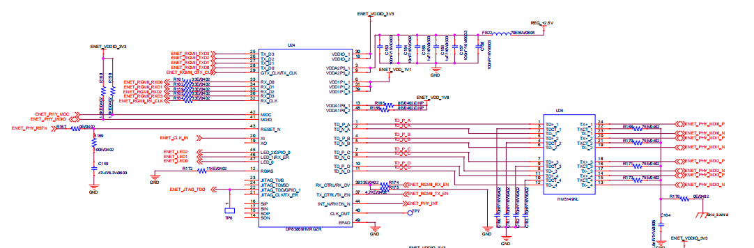

I am working on MIMXRT1176 custom board interfaced to DP83869HM ethernet phy. The hardware connections are given as shown in below image.

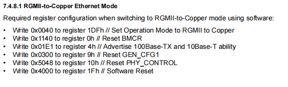

We have configured the phy as mentioned in datasheet for RGMII-Copper mode:
Then the ping is working for 10mbps but when changed to 100mbps then it is not working.
Is there any timing registers need to modify?

    Does the configuration is correct ? or any changes/extra registers required for below image configuration?

    No other configuration is needed. I do not believe it is configuration issue since the PHY is linking up in 10M? What is the cable length? If the cable is not a good cable, the PHY and the LP may link up in 10M even though they both support 100M because of poor signal quality. Have you tried it on different LPs? Have you also tried disabling auto-negotiation and forcing 100M connection? You can write 0x2100 in register 00h to do so.
