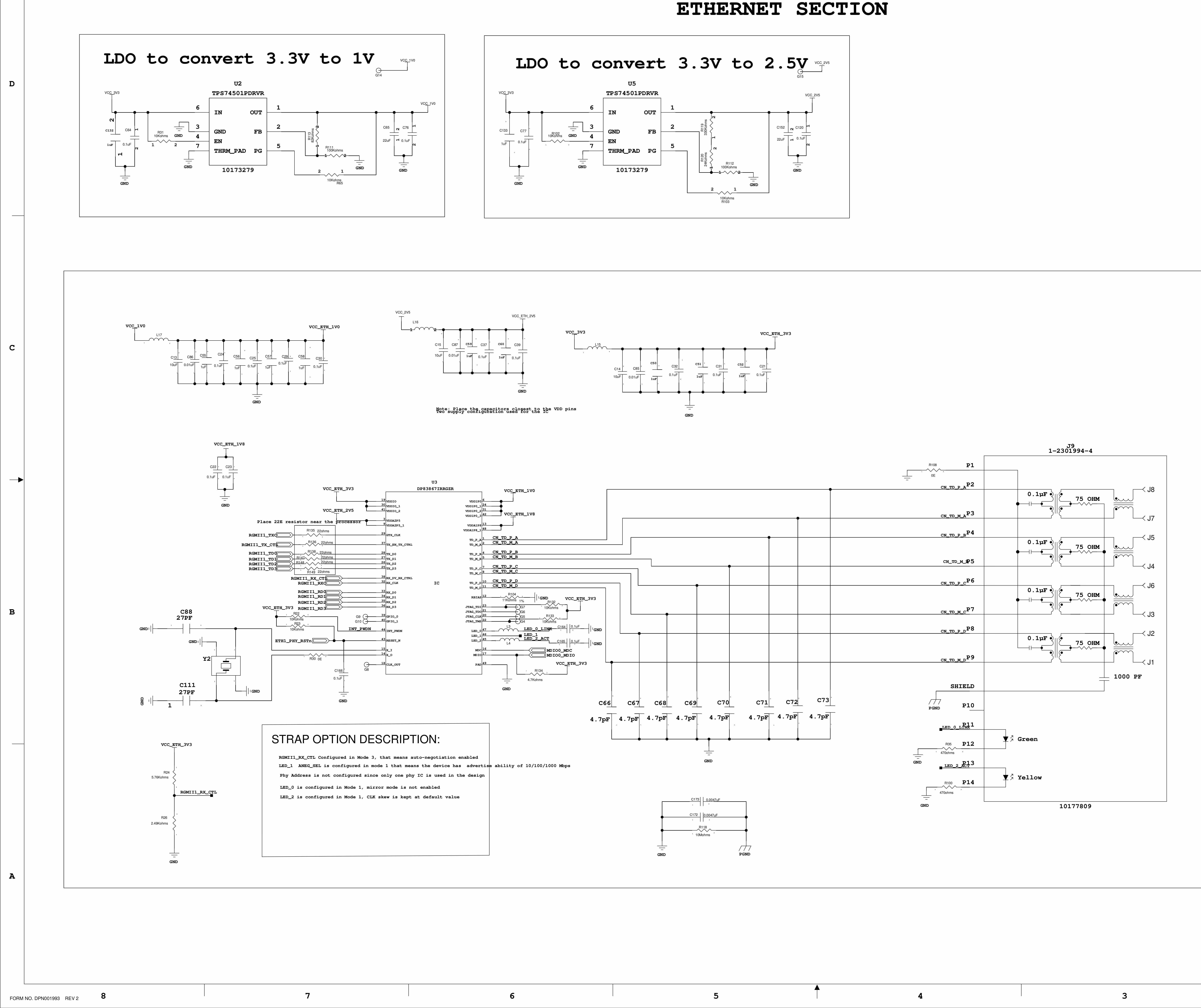

I am using DP83867 with TI Am625 processor, and getting the error as below, where the phy is getting detected but the link is not up, due to forced master error, but it is configured as auto in the dts as well as in hardware,
Please review the schematic for potential error and the possible resolution for the same.

  • Hi Rishav,
    Can you access the PHY registers via MDIO?
    Why are there capacitors on the MDI line? We typically do not see such design and that can cause link failure.

  • Hi J,
    Thanks for your response,
    Yes we can read the MDIO registors (we can read and write all the phy registors succesfully)
    Key observations:
    Loopback test failed
    phytool read eth0/0/0x10
    0x5048
    phytool read eth0/0/0x0e
    0x0017  # After running TDR test
    hytool read eth0/0/5
    0x0000  # Link partner ability register is EMPTY
    Please respond with your inputs on the same.

  • Hi Rishav,
    Which loopback have you tried?
    Can you remove the capacitors (C66 to C73) and see if the PHY links up?
    Can you also measure first link pulse on pair A and B of the MDI line?
