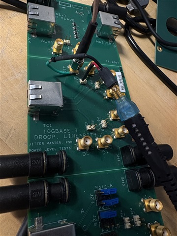

I've been trying to enable the test modes for verifying the design with the Tektronix automotive ethernet test solution: https://download.tek.com/datasheet/TekExpress-Automotive-Ethernet-1000BASE-T1-100BASE-T1-MSO6-Datasheet-61W614083.pdf?_gl=1*yzq23h*_gcl_aw*R0NMLjE3NjIyOTcxMzIuQ2owS0NRaUE1YWJJQmhDYUFSSXNBTTMtekZVNmIyZ2JiNmtXNDdWckM0RkdjMmJ3aHc1RjlhRTdjM1E1Y1FYeHFzQWdmN09mV3ZKR0Uxd2FBcUpIRUFMd193Y0I.*_gcl_au*MjEyNDg0NzM0LjE3Njc3MzIyNTguMTEyMjY2NjE4Ny4xNzY3NzM0MzU1LjE3Njc3MzQzNTQ.*_ga*NTI2NzE1NjE2LjE3NTkzNzg4OTQ.*_ga_1HMYS1JH9M*czE3Njg2MDI4NTYkbzIwJGcwJHQxNzY4NjAyODU3JGo1OSRsMCRoMA..
Using the DP83TG720 EVM to start, it seems when I use the USB-MDIO tool that writing to this test mode register (TEST_MODE_CONTROL register at offset 1904h) and reading it back results in the register still reading as 0000h.
Any idea why that is?

    Not sure if this should be a new forum post, but I'm having trouble getting past the transmitter timing slave jitter test (test mode 1).
    Are there extra steps required setting the DP83TG720 in slave mode then enabling test mode 1?
    The Tek scope just says 'Configured channel source has no signal.'
    It gets through transmitter timing master jitter just fine.

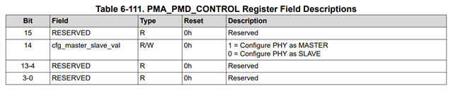

  • Hi Alex,
    Is the device currently configured to master or slave mode? You can configure this either through bootstrapping or register writes. Using register writes, this is configured in reg 0x1834, as seen below.
    Greg
  • Hi Gregory,
    I think I'm setting it as slave correctly:
    // DP83TG720 PHY address is 0x08
    begin
    // Set PMA_PMD_CONTROL Register (Offset = 1834h) [Reset = 8001h]
    // Requires indirect addressing: (sec 6.4.9.2 of datasheet)
    // https://e2e.ti.com/support/interface-group/interface/f/interface-forum/1608641/dp83tg720evm-mc-dp83tg720-register-access-for-test-modes
    000D 0001
    000E 0834
    000D 4001
    000E 0000
    // Read back
    000D 0001
    000E 0834
    000D 4001
    000E
    end
    When I set it to master, I see a signal with test mode 1. It just goes away in slave mode.

    If helpful, I also attached my scripts for setting master, slave, test mode 1, and reading the registers.
    begin
    000D 0001
    000E 0834
    000D 4001
    000E 4000
    // Read back
    000D 0001
    000E 0834
    000D 4001
    000E
    end
    begin
    000D 0001
    000E 0834
    000D 4001
    000E 0000
    // Read back
    000D 0001
    000E 0834
    000D 4001
    000E
    end

  • Apologies Greg,
    I was not setting up the master/slave transmitter timing jitter tests correctly. I had misread the Tek manual and thought the test could be done without TX_TCLK access.
    After re-running with TX_TCLK SMA connector connected to a diff probe on the TF-XGbT test fixture, I get transmitter slave timing jitter passing now.
    Master timing jitter and MDI jitter fail, but there are other factors I want to rule out later in the week. (Grounding and this GND pigtail I used to pass CLK_OUT to a diff probe.
    Thanks for your help!
