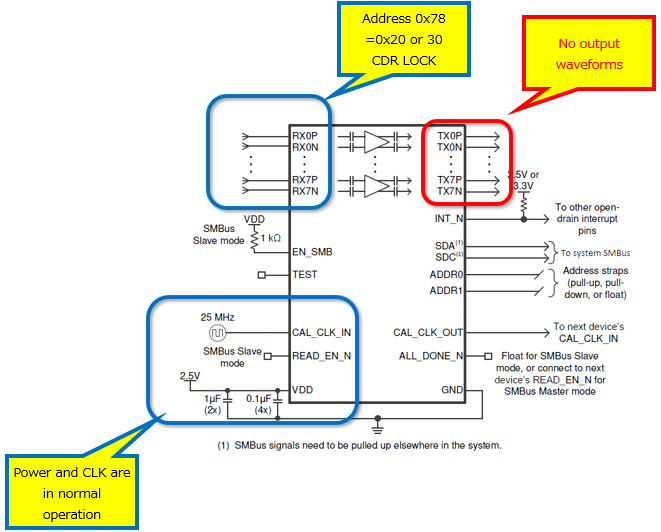

Hi team,
My customer designed the circuit with DS250DF810 which is used for the 25G communication between FPGA and ethernet PHY. My customer is able to confirm the CDR lock on the input side(RX0N, RX0P, ~ RX7N and RX7P), but My customer cannot observe the output waveform on the output side(TX0N, TX0P, ~ TX7N and TX7P). My customer would like to confirm what happens in DS250DF810.
  1. Are there any registers which show the current situation in DS250DF810?
  2. Are there any registers which my customer should configure to fix this issue?

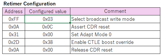

    • How is customer measuring signal at TX?
    • Which register is the customer using to determine CDR lock?  Could they check and share value for register 0x02.  This will have more details on CDR status.
    • If customer performs channel register reset, ch_reg_0x00 = 0x04, after "Select broadcast write mode", does this impact observations?
    My customer has measured the TX signals by the differential probes and the oscilloscope which is DSA-X 93204 from Keysight. TX measurement is same with RX measurement.
    My customer has checked the address 0x78, and found out all lanes of 0x78 are 0x20 or 0x30.

  • Hi Drew-san,
    My customer doesn't know how to execute "Select broadcast write mode". Could you please kindly advise me hot to do it?
    Shunsuke Yamamoto
    Is the customer measuring output on channels with CDR lock?  Does the customer expect some channels not to have CDR lock?  0x20 indicates no CDR lock.
    I'm confused on this point, can you help clarify where they are stuck?  They need to write to register 0xFF and set 0x03.
    Customer appeared to already be doing this based on configuration shared in original post.
    What does 0x30 mean? I will also confirm if CDR is locked or not again.
    My customer has checked the address 0x02, and the value of 0x02 is 0xd8.
    0x30 indicates CDR lock.
    This also indicates CDR lock.
    Was customer able to figure out the configuration sequence including channel reset?  Did this have any impact?
    In general, DS250DF810 will by default lock to 25G signal and will transmit signal once it has CDR lock.  If device has CDR lock, customer should be able to observe an output unless some additional configuration has been applied.
