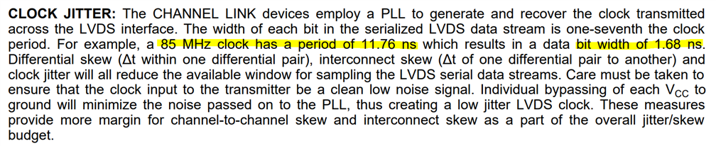

    This is correct, at 85 MHz clock rate, the data lanes are running at 7x (85MHz).
    85 MHz * 7 = 595 MHz
    And at 595 MHz frequency, the bit period is 1.68 ns.

    All values of Tppos_N can be discribed as Tppos_N = 1.68ns * N +/-20ns, where 1.68ns comes from 85MHz * 7 = 595MHz.
    Similary, Rspos_N = 0.84ns + 1.68ns * N +/- 0.35ns.
    To calculate RSKM, below is given by using (1),(2),(3)
    Left Bit Margin = Rspos_N_min - Tppos_N_max = (0.84ns - 0.35ns) – (0ns + 0.2ns) = 0.290ns
    Right Bit Margin = Tppos_N+1_min- Rspos_N_max = (0ns + 1.68ns - 0.2ns) -  (0.84ns + 0.35ns) = 0.290ns
    because terms with N as a coefficient cancel each other out.
    So there are still three terms which might change at 50MHz. Can you please check how to change at 50MHz in theory? Customer would like to know the ideas, not a exact value.
    0.84ns is a value of typical transmit time.
    0.2ns is a Tppos_N max error.
    0.35ns is a Rppos_N max error.

    The cable should ideally work at 85 MHz too. What frequency is the cable rated for? You could increase the PCLK and test with 85 MHz to check whether it meets the spec.
    Calculating RSKM
    The left and right bit margins are calculated based on these equations:
    Therefore, from the calculation app note table "Table 3. RSKM Calculation for DS90CR287 and DS90CR288A Pair at f = 85 MHz",
    • Rspos0 left margin = 0.49 - 0.2 = 0.29 ns
    • Rspos0 right margin = 1.48 - 1.19 = 0.29 ns
    • Rspos1 left margin = 2.17 - 1.88 = 0.29 ns
    • Rspos1 right margin = 3.16 - 2.87 = 0.29 ns
    DS90CR288A - RSKM at f=20MHz
    According to this E2E (above), you can estimate RSKM taking RSKM as a fraction of the the bit period. There RSKM for this DS90CR287 is 290ps which is 17% of the bit period at 85 MHz.
    At 50 MHz, 17%* (1/50MHz * 7) = 485 ps.
    Note: this is an estimation based on the E2E suggestion and not characterized.
    Our best advice would be to run the system at 85 MHz PCLK instead for testing and check whether the RSKM specs are met. Ideally, if it meets the requirements at 85 MHz PCLK, it would work at the lower 50 MHz frequency as well. This should be tested especially if the cable is already rated for 85 MHz like many common LVDS cables.
