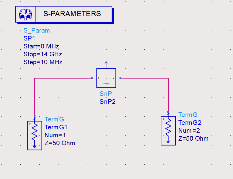

  • Hi Haohao,
    ESD601-Q1 is almost always going to be used in a parallel configuration so ESD events have a path to ground (can be seen in image below).
    When we collect our s-parameter data, we use our ESD EVM. The schematic is shown below. One pin is connected to ground and the other is connected to both ports.
    When I run both simulations you have shown above, the left hand one shows what I expect for S21. When I run the right hand side and select S21 to show, I am getting what I would expect for S11. Based on this, I believe the left hand simulation image is correct.
    McKenzie
  • Hi,McKenzie:
      I want to say if using the left simulation circuit,how to protect  circuit?
      Hower,even it will change impedence of port1/2 if using the right simulation.The signal of the port1 is not tranferfed to the port1,as below
  • Hi Haohao,
    The image below looks like the termination is connected to both pin 1 and pin 2 of the device but this is a misunderstanding. When the s-parameter data is collected, pin 2 of the device is connected to ground while pin 1 is connected to a two port system. This then follows the image below. The ground connection would be pin 2 with the two port connections (the two terminations) going through pin 1.
    When you protect the device in a circuit, you would follow the schematic below.
    McKenzie
