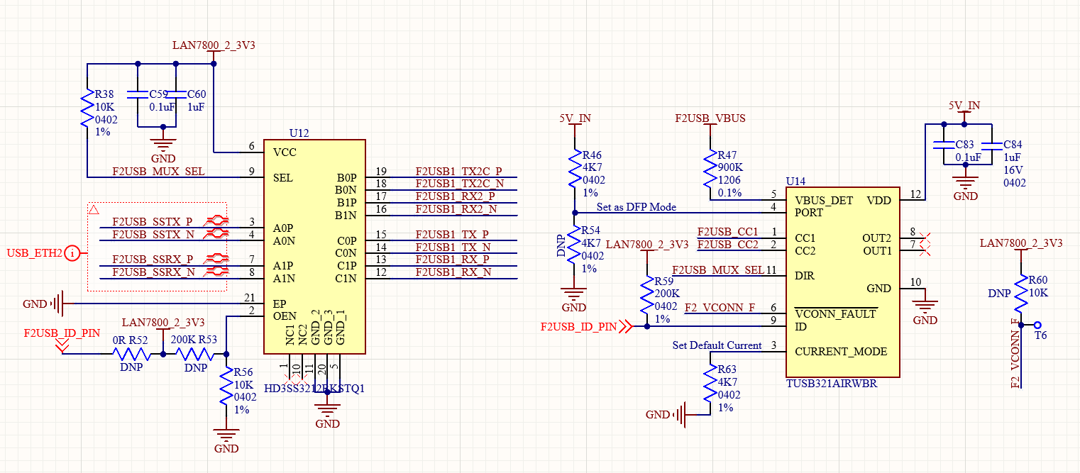

  • Hello Vishesh,

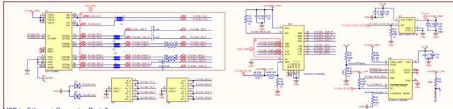

    I am unable to upload the full schematic PDF so i am attaching the screenshot of the schematic.
    We have follow the below points;
    1) With the TUSB321 powered down can you test both orientation of the USB Type-C cable?
      We have tested the both orientation that is correct.
    2) Power the TUSB321 and probe the DIR pin. See the status of DIR in the normal and flipped orientations.
      DIR PIN is correctly HIGH and LOW when the cable is normal and flipped.
    3) Use a continuity tester to see if the MUX is being routed correctly. If SEL = 0, then the common signals should be connected to port A. If SEL =1, then the common signal should be routed to port B.
     MUX  is properly working When the SEL=0 the Port-A to Port-B routed we have tested with mulitimeter, and SEL=1 then Port-A to Port-C routed correctly.
    4) Make sure the DIR polarity of TUSB321 matches the desired routing of HD3SS3212
      polarity is also match.
    It may be easier to use the HD3SS3220 which incorporates the TUSB321 and HD3SS3212 into a single package.
      Thnaks for your suggetion, In second revison we will definatly use the HD3SS3220 single IC, but now we need to run existing custom PCB board. If it is not run we will not proceed with HD3SS3220 IC
    The IC is not working as expected, Is this possible to visit technicial in our office to solve this issue?
    Our application block diagram:-

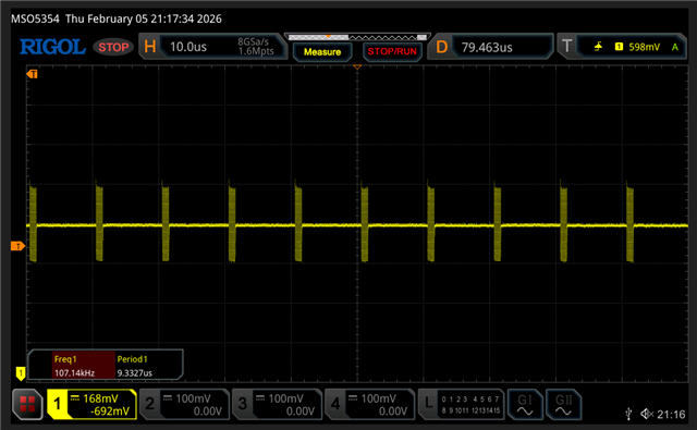

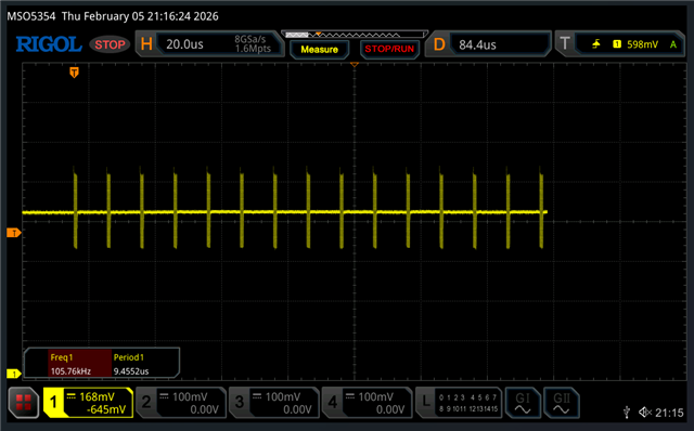

    Can you probe the CTX connections and see if the USB host/ device is outputting LFPS waveforms. This should look similar to a clock.
    Please find the below LFPS waveforms:-
    Please suggest a suitable solution to help us bring up our board successfully.
    Thanks and regards,
    Jai Kishan
    If LFPS waveforms are being sent out, then the MUX and TUSB321 are operating correctly. We see that data is being transmitted from the host to the connector. Is it possible there is an issue in the USB firmware on the host side?

    The LFPS waveforms shared are when VCC is not supplied to TUSB321?
    Please test everything with power supplied to TUSB321. Can you share what the USB outputs look like when TUSB321 is powered.

    Would it be possible to show where the ID pin is routed? I see the pin has a net name, but not where it goes.
     :-  ID pin is routed to MCU image given below

    Is this in both directions of the type-C cable, or in only one direction? If there is no CC controller, typically the USB3.0 connection will only work in one direction, or will only work in USB2.0. If it works in both directions, that would lead me to think there may be an issue in the routing of the USB 3.0 signal or the routing at the mux. Please help to confirm if the USB3.0 signal works in both directions without the CC controller, or only one direction.
    Jai Kishan Said:- When no power is applied on the TUSB321 then USB3.0 is works both direction. We have read the ID pin using MCU When the ID pin low the charging enables and load switch turns ON and power applies on Vbus. but phone does not charge.
    One thing I would like to test if that's okay, if you disable the HD3SS3212 by pulling the OEN pin high, are you able to see a USB3.0 or USB2.0 connection in either direction? I would like to see if the mux is having any effect or not on the connection.
    Jai Kishan Said:- We have pulled up the OEN pin, the still USB3.0 connections are made with both direction.
    Thanks and regards,
    Jai Kishan
  • Hi Jai,
    9AM Dallas time Wednesday would work, yes.
    We are OOO today for the US holiday, I will follow-up on your other points tomorrow.
    Ryan
  • Hi Jai,
    This is likely because the connected phone is configuring as a DFP, rather than a UFP. This is because of dead-battery mode on the TUSB321, where when there is no power applied to the TUSB321, the CC pins will be pulled down to GND with the value Rd needed to detect a UFP. This will cause a data connection to be made, but the phone will not be charged, as it is instead trying to supply power due to how it is configured.
    The thing that is odd to me is that USB3.0 works in both directions still. The HD3SS3212 should not be flipping if the TUSB321 is not sending any signal through the DIR pin. Can you confirm the DIR pin is not changing? I would expect it to be constantly pulled high or low, not flipping based on the direction.
    If the DIR pin is not flipping, then the SEL pin of the HD3SS3212 should be stuck in one orientation, meaning that the type-C connection should only work in one orientation. It working in both directions even when the TUSB321 is disabled makes me think that there is an issue with the USB-3 signal routing from the type-C connector to the mux.
    This should not be possible, the connections should either work in one direction or not at all. Would it be possible to review the layout surrounding the USB-3 signal lanes and ensure these are routed correctly from the connector to the mux?
    Ryan
