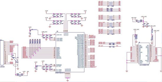

We are using DS90CF384AMTD ic in our one of the converter (LVDS to TTL 18 bit)  board. We are observing one strange behavior with this IC, when the board is powered up and there is no LVDS input, output starts showing white screen with colored lines on LCD panel even after asserting  /PWRDWN pin. Also, if we plug out the LVDS input while the system is running, the output retains the last display and after a delay it shows white screen with coloured lines. This patterns changes nearly every time.
As per our assumption, the LCD should show black/blank screen in case of no input.
The same design is working with DS90CF584MTD IC with desired output.
Please help me.

  • I think the behavior is most likely due to how your panel deals with no signal.
  • Greetings -
    As Ross noted, this is usually a setting in the TCON device on how it responds to unexpected timing.  There are some differences on how various LVDS DES respond to open inputs.  As just noted usually the TCON will detect the random timing and block it from reaching the panel.  The device noted has a PLL in it and with no inputs applied, it could be switching on the presense of noise and generating the random outputs.  A possible solution if the TCON cant block it would be to try adding a high impedance pull up to the LVDS CLK input (plus) to VCC, and a Pull down on the minus input to GND.  Perhaps try 1k Ohm.  This will likely make the LVDS CLK strap to a stable state, and prevent nosie from passing.  Some of the older / other LVDS DES have a different approach to the PLL blocks and may be more robust to switching on noise.
    When the PWRDOWN pin is asserted all DES outputs are LOW (static), if noise is still seen on the panel, this is another sign of a TCON devicve setting or unusual operation.

  • Hi John Goldie,
    The above solution did not worked for me, still getting same output on my tft panel.
    I am using Primeview PD064VT5 TFT LCD panel.  Below is the snap of my design, Kindly guide me.
    Shailendra Singh
  • Greetings -
    From what I could see in the schematic, looks to be a correct connection to the DES.  I am concerned that your statement of asserting the PWRB signal did not change this problem.  That tells me that by setting the PWRB pin low, the DES outputs go to a LOW, and the probelm still occurs.  This indicates a probelm in how the TCON is responding to the no input case.  Register settings / firmware should be reviewed on that device to root cause the probelm.  I assume also the same TCON is used in the older and current design?
    These are more along guesses at this point, but you could also try:
    a) adjust the failsafe resistors (pull up and down) to a smaller value for strong bias, 750 Ohm for example.
    b) try related part - DS90CF384MTD - this one acts more like the older DS90CF584 that you reported as OK.
    c) repeat the PWDB test and verifty outputs and clock are stable.
    John Goldie
