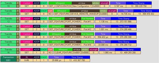

We are applying  TUSB2046B as figure13 page15 on the datasheet to our system circuitry.
Questions are,
1)While the system power up with USB cables connected into all 4 ports(DM1/DP1~DM4/DP4).
  How about the USB bus power up turn for 4 ports(DM1/DP1
→DM2/DP2.......)
2)How about the USB Hand-Shake process complition turn for 4 ports?
   (DM1/DP1
→DM2/DP2.......)

    Exactly, your understanding is correct.
    We want to know the sequence about "5V power supply" and "USB communication"
    sequence for 4 downstream ports when the power up.
    I checked on the lab and the TUSB2046B always follows the sequence Port#1, Port#2, Port#3, Port#4 to apply power and to start enumeration as well.
    The below screenshot is from a bus trace at the power-up/enumeration process.
    Regards.
