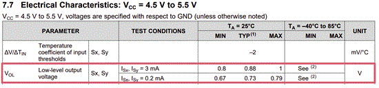

I asked about 5 days ago with the subject of "82B96: Question about using 1 peace of 82B96" and received an answer, but I received the following additional question/request.
"Would it be possible for you to tell us the VOL characteristics of Tx and Ty in the form of the VOL characteristics of Sx and Sy in the red box in the table of item 7.7 below?
I think VOL is only mentioned as a condition or rating in the table in section 7.3.
In order to confirm whether the VIL regulation of the master side can be satisfied, the VOL regulation of the buffer IC is necessary.
We are also concerned that the characteristics of Sx and Sy may change depending on the current value.
I would like to know exactly the VOL characteristic values of Tx and Ty together with their measurement conditions."

  • Hi Takashi,
    The best data we can gather is from table 7.3 recommended operating conditions. The maximum IOL is given. This means that at any VOL lower than 0.42V will yield a current load < 3 mA.
    Same idea for Tx/Ty. A max IOL = 30 mA is given when VTx, VTy = 0.4 V. A VTx, VTy < 0.4 V will yield an IOL < 30 mA. And this is across operating free-air temperature (-40C to 85C).
    If you design for the maximum IOL spec, your IOL will be lower for an output low voltage < 0.4 V which is adjusted through the choice of your pull-up resistor.

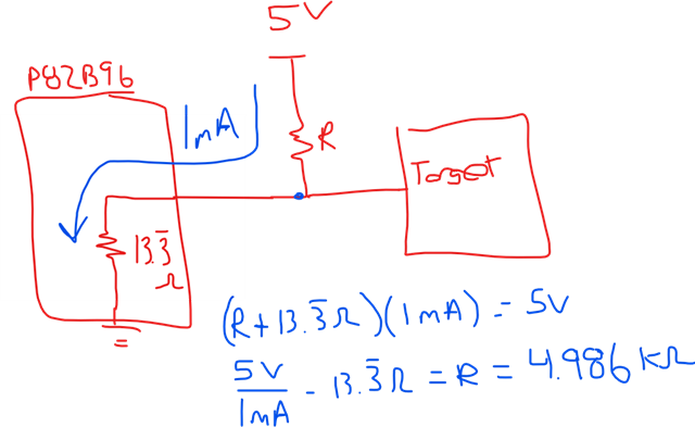

    Yes this is correct. If your Transmission side pull-up voltage is 5V, and you design for only 3 mA of IOL, then you can adjust the pull-up resistor to sink the current required for your target device.
    Resistance of the driver is ~ 13.333 ohms
    I performed some rough calculations.
    Based upon a 1 mA current sink, a Rpull-up of 4.986 kohm would sink roughly 1 mA of current through the driver.
    THis would result in a VOL = 0.0133 V, which is a very low VOL to the target and should satisfy any I2C target whose VIL = 0.4 V.
    Now you do have to take into consideration the rise time of using a 4.986 kohm PU resistor with your system. If the bus capacitance is too large, your rise-time may be over spec.
