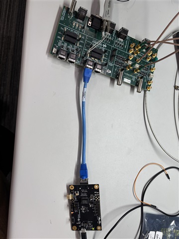

    I reviewed the waveforms. I tried similar setup in the lab with our EVM and I see 1.7V FLP without changing pulse width. I think the pulse width changes because of your measurement setup. This is measured from P2 equivalent of your measurement setup. Below is our screenshot of the waveform:
    We used our Ethernet compliance setup (Keysight UXR0334A with compliance breakout board + E2678A differential probe head + N
    Below is the image of our setup:
    In addition, because your board is linking up in some cases, I doubt this is the FLP issue. If the FLP were to be the issue or out of IEEE specification, none of your setups that have autonegotiation enabled will not link up. I
