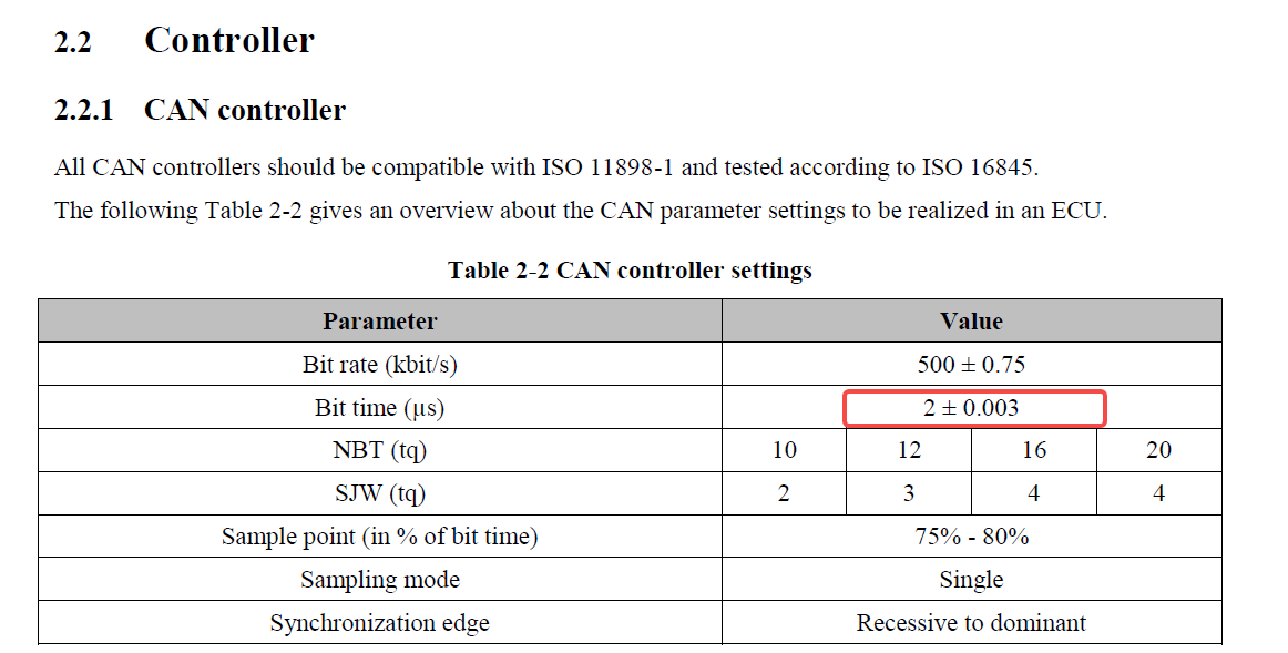

We are evaluating the TCAN1145-Q1 for a CAN application at 500kbps and have a specific requirement regarding bit time accuracy. Our customer’s specification requires a bit time deviation of 3ns over 2µs (i.e., 0.15% accuracy).
Could you please confirm if the TCAN1145-Q1 can meet this level of bit timing precision? If not, we would appreciate it if you could recommend alternative TI devices that can satisfy this requirement.
Here are the specifications for CAN:
Thank you for your support.
