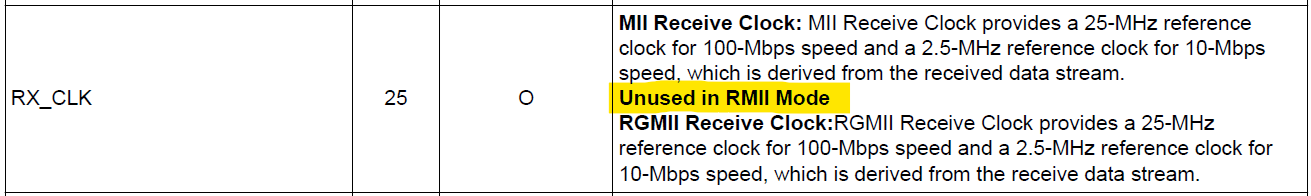

snls505g Table 6-1 says that RX_CLK is unused for RMII:
Please confirm that it is possible to output the Recovered CDR clock on the RX_CLK pin in RMII Master mode (25 MHz @ 100 Mbps ?).
Which register bits would have to be configured to output the (100 Mbps) Recovered clock on the RX_CLK pin in RMII Master mode, please?

  • Hello Shane,
    My formulation of the question was unclear. Is any Recovered (CDR) Clock available on RX_CLK in RMII mode, and, if so, what would the RX_CLK frequency be? Are any special register configurations required to enable this?
    The pin description quoted in the original post says that the RX_CLK pin is unused in RMII Mode, hence the question. Perhaps what was meant is that RX_CLK is not *required* for the RMII interface (but is nevertheless available)? Other sections in the UM indicate that RX_CLK is optionally available, so a clarification might be helpful.
  • Hi Bernhard,
    There is a register to output the 50MHz RMII clock from the RX_CLK pin. Please see 0x000A[0]:
    I tested this today on our DP83822EVM and can see a 50MHz clock from RX_CLK when this bit is set. I believe this is what the datasheet means by optionally available.
