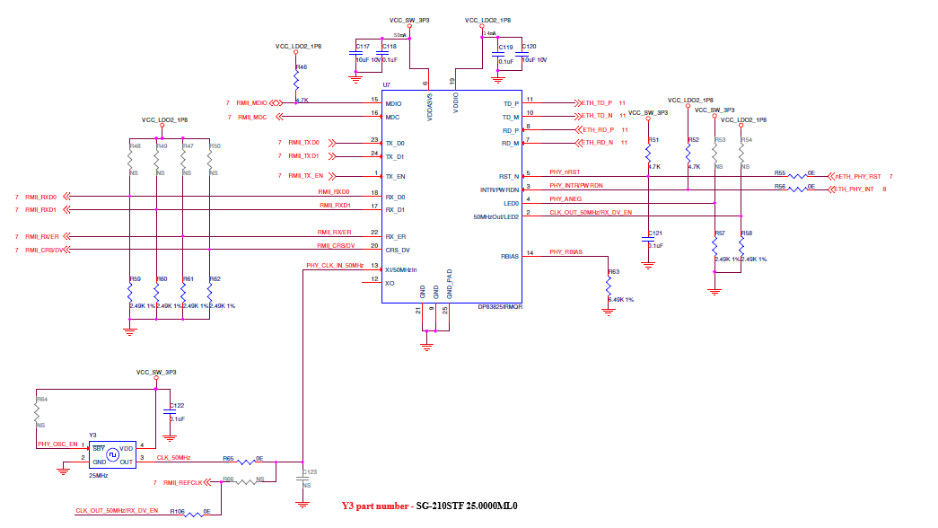

we have used the DP83825IRMQR part in one of our device requiring 10/100Mbps network connection.
We faced the below mentioned issue in 2 out of the 30 numbers of PCB developed by us with this PHY IC . Attaching the schematics of the design.image.png

  • Hi Amal,
    Since the fail follows the IC, it could be that something is causing these units to fail. I have a few questions to help determine this:
    • Are you performing any stress testing on the boards? (EFT, ESD, ...)
    • Were these 2 units failing originally or did they start failing after a certain point?
    • What is the link partner in these tests?
    • What cable length is used?
    • Do you notice any other symptoms from the failing ICs?
    • Can you provide a register dump of a failing IC vs a working one in the link up condition?
    The schematic looks ok from the image you've shown, though this does not show the full MDI path. I recommend evaluating your schematic with the DP83825 schematic checklist. You can use the 'pin wise checklist' tab in this document to look for discrepancies from our recommendations.
