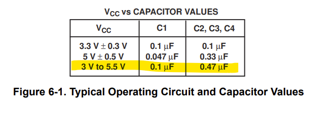

Hello team,
My customer have below questions regarding C1~C4 in typical application, can you support please?
  1. Vcc=5V, is it okay to use 3V to 5.5V table? They want to use 0.47uF for C2~C4 especially. image.png
  2. Should they consider capacitor DC bias characterisitcs?
  3. They select 15V torelance for C1~C4, is it enough torelance?
