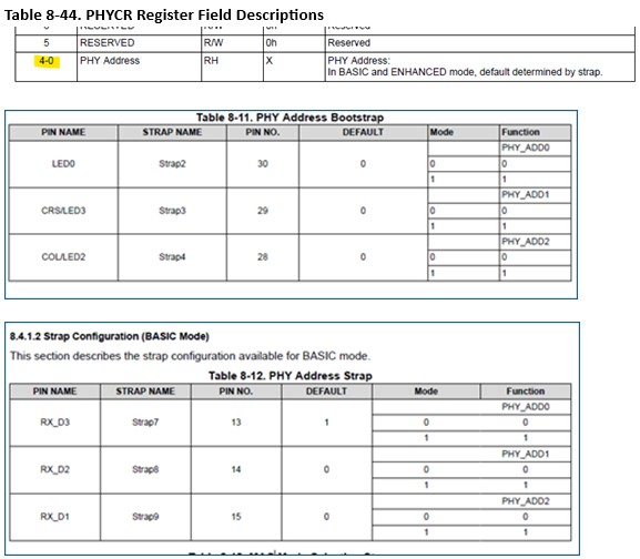

According to “Table 8-44. PHYCR Register Field Descriptions” in the DP83826AI datasheet, the PHY address is 5 bits.
However, I can only find three strap pins for the PHY address.
Which information is correct?
If the PHY address is 5 bits, which pins correspond to the PHY_ADDR[4:3] straps?
