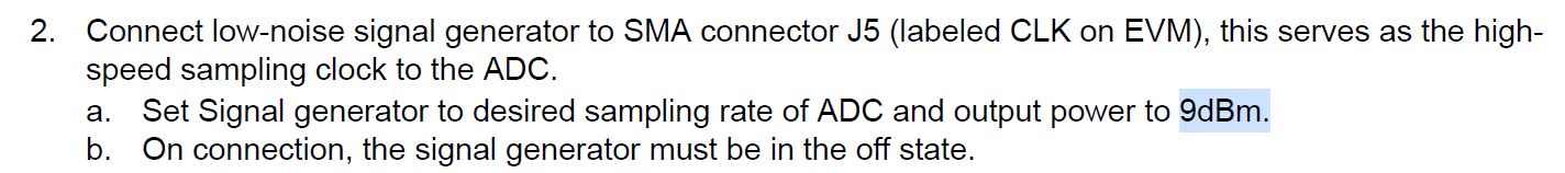

I have two questions regarding the ADC34RF72EVM.
  1. The user guide (SLVUDB9) states that the ADC clock input at J5 should be driven at 9 dBm.
    • If the input clock power is lower than 9 dBm, does this cause measurable ADC performance degradation (e.g. SNR / ENOB)?
    • Is 9 dBm a strict requirement or a recommended level with margin?image.png
  2. Is the ADC34RF72EVM intended to be clocked directly from an external signal generator?
    • Since the board includes an LMK04828, can the ADC be fully clocked using the LMK04828 output without an external clock source?
    • If so, what is the intended use of the external clock input (J5)?

  • HI Seungbeom,
    1) - no, using a +9 or +10dBm increases the slew of the clocking edge and actually increase SNR/ENOB performance. We also typically assume the customer will follow the use guide and use a sig gen and bandpass filter, which will reduce the signal swing that eventually gets to the ADC clocking pins.
    2) - yes, clocking directly from a sig gen is best. The LMK is used to derive the refclk for the FPGA.
