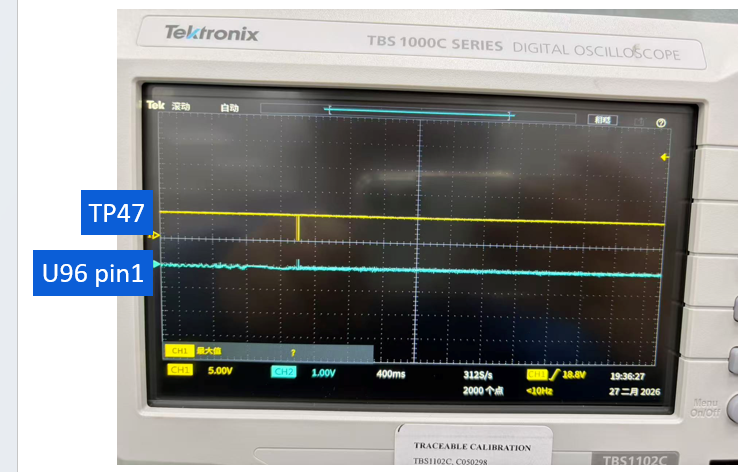

SN65HVD256DR  can h and can l have noise when the environment temperature decrease 5℃ or less ?
the CAN communication link (waveform captured by a logic analyzer) shows noise roughly every 6–7 seconds.
what may cause that?

  • termination resistance is 60 ohm. I have tested it ,the noise is still when the temperature is low(5℃ or less).  I have tested the power rails of this IC,the 5V didn't have obvious change when the noise occurs. the MCU seems OK and the can waveform is like this. I have stop other nodes (remove U96 and U97
    SN65HVD256DR from PCBA.) P24 didn't connect any node. but the issue is still. the schematic is shown as the following. can you help analyze?

  • hi Michael
    yes, has removed all can nodes,CAN h and can l still has noise. I have tested canh and RXD signal,the test result is shown as the following.
    please help analyze ,thanks very much.

  • OK, I will test it.because it is APQP boards,  for one of the issues boards, I have found the noise source, it come from one unused node, when the temperature become low , the pin 1 of U96 has the noise ,which is shown as the following figure. so I pull up pin 8 to high(voltage) to disable the U96, For this PCBA it seems that the solution is OK.
    but for the other PCBA , the solution it seems not OK. when the U96 is disabled(pull up pin 8 to high(voltage)) , the noise is still. can you help analysis?
    best regards
    zhuo
  • Hi Zhuo,
    It would seem the noise is coming from the supply and would recommend ensuring sufficient decoupling capacitors are included as close as possible to the IC pin to double confirm, thanks.
    Michael.
