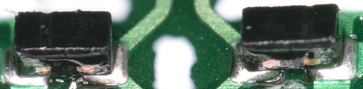

5. Review of actual assembly condition
The customer has attached photos of their actual assembly condition.
They are concerned that the solder volume may be excessive.
Could you please share your opinion on this, and also advise on possible countermeasures or improvements if applicable?

  • Hi Maia,
    No worries! For precautions, the main thing will be the tilt of the diode after soldering. A tilt can happen across the long-axis due to the small size of the package. This is normal but some customers are initially concerned by it. To manage tilting, it is best to follow the stencil design and control the amount of solder paste. Too much solder paste can lead to higher amounts of tilting.

    I have some pictures but they aren't the highest quality due to the package being so small. But I did want to share this image below.
    So based on the images you provided in your first post, it looks like the device being soldering like the first picture. Is the correct stencil and land pattern being used? Looking at one of the pictures I took, you can't see solder at all which means it is fully under the device.
