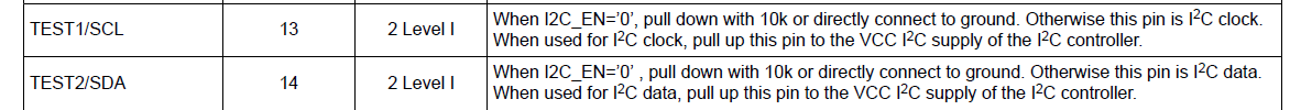

We saw the datasheet of TDP142-Q1 about PIN13 and Pin14 have two question:
Q1: "pull up this pin to the VCC I2C supply of the I2C controller "  should I external pull resistor with 1.8V?  if yes, any suggest resistor value?

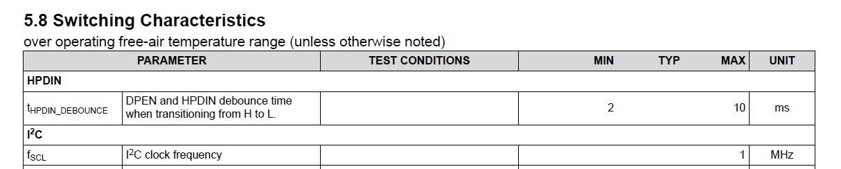

Q2: About I2C default speed is 1MHz?

  • Hi Lawrence,
    Typically, I2C runs in 100 to 400kHz and that is also the case for this device. We can support up to 1MHz.
    For I2C pullup, please use 4.7k pullup.

  • Hi J,
    Thank you for your reply. Let me confirm the scenario as below:
    i2c_en ==> f = i2c enabled at 1.8V when rsvd11 = "0" and rsvd10 = "0". Otherwise, it is in GPIO mode (i2c disabled).
    So, to enable I2C at 1.8V, the following three conditions are required:
    (1) i2c_en = f (float, leave pin open)
    (2) rsvd11 = "0"
    (3) rsvd10 = "0"
    If yes, do pin 13 (test/scl) and pin 14 (test/sda) need a 4.7k pull-up resistor?
    Note:
    in Fast mode(400kHz) pull up resistor range is 620ohm to 2.2k, typical is 1.5k?
    in Fsst mode+(1MHz) pull up resistor range is 1.5k to 2k, typical is 4.7k?
    if any suggestion, Please advise me.
    Lawrence
  • Hi Lawrence,
    (2) rsvd11 = "0"
    (3) rsvd10 = "0"
    Yes, this is correct. I advise to keep 4.7k for both modes of I2C.
