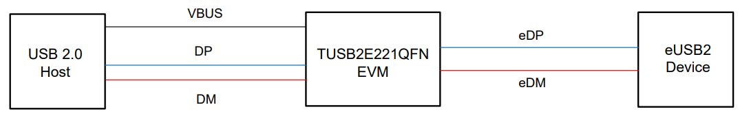

We are designing an eUSB2 FS peripheral device.
As per the eusb2 specification, CM.RAP is optional and other CMs are supported only in repeater mode.   undefined
If we configure TUSB2E221 as a device repeater, and connect our eUSB2 device:
Does the eUSB2 device need to communicate with TUSB2E221 by CM?
Our eUSB2 device only support FS speed, could the configuration be done by I2C or GPIO?
    Section 5.4 of the eUSB2 spec goes into detail on the commands and signals needed for peripheral orientation with an eUSB2 repeater. Going by the spec, CM lines are not required to configure the repeater as a device/peripheral.
    Yes, only I2C or GPIO can be used to configure the repeater. CM.RAP functionality is not required to configure EQ or other configuration settings.

    In Figure 5-11, CM.Lx/CM.FS is used to change the state from L0 to Lx, will TUSB2E221 use this CM in Device repeater mode?
    We planned not to implement CM in our device, could the device just stay in L0?
    BTW, the "Bus Reset" in peripheral mode does not need to use CM.Reset, is my understanding correct?
    I2C can be used to configure the repeater to device repeater via CONFIG_PORT0/CONFIG_PORT1 register, is my understanding correct?
    Could you also tell us how to configure the repeater to device repeater by GPIO?

    I would recommend using an EVM to confirm that this is the case.
    We have ordered TUSB2E221QFNEVM from the distributor (Mouser). But we don't have any eUSB device now.
    Could we connect TUSB2E221's eUSB2 Port0 to Port1, and measure the eUSB2 signal?
    You want to test the eUSB functionality by connecting eUSB port 0 to eUSB port 1? This will not work, as an eUSB host or eUSB peripheral is needed to configure the repeater, connecting these ports together will not do anything.

    I believe this is primarily determined by timing on the eUSB lanes. Section 4.3.3.1 and section 5.5.2 have timeline markings in their figures to show when a certain signal is transmitted and by what. In section 5.5.2, it looks like eUSPr transmits Port Reset to the peripheral, while in a native configuration, eDSPn would transmit Port Reset.
    The primary difference is likely in the timing, where after a certain time in where the peripheral does not detect a Port Reset from a host, which leads it to instead transmit it's own Port Reset to try and perform repeater configuration. In the figures for both these sections, you can see a difference in the timing of the native configuration versus the repeater configuration. This same process also occurs for host mode repeater configuration.
    Ryan
  • Hi Ryan,
    Thanks a lot.
    Is there a typo? In section 5.5.2, eUSPr transmits Port Reset to the repeater (eDSPp), not the peripheral.
    We also think so, but we don't know how long the peripheral should wait before transmitting its own Port Reset.
    Do you know where can we find the information?
  • Hi Andrew,
    Sorry, yes eUSBr transmits to eDSPp on the repeater, transmitting Port Reset to the peripheral would just be a loop Sweat smile
    I am looking for it in the spec but I'm not totally sure either. I would recommend reaching out to the USB-IF to see if they can answer it exactly using the email listed in the spec: techsup@usb.org
    Ryan
