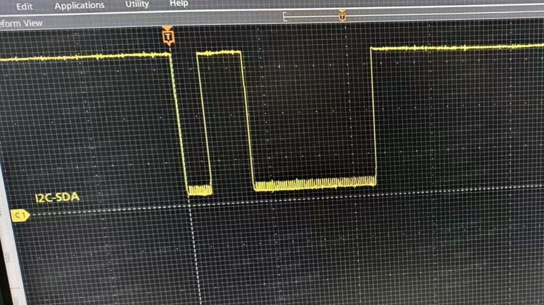

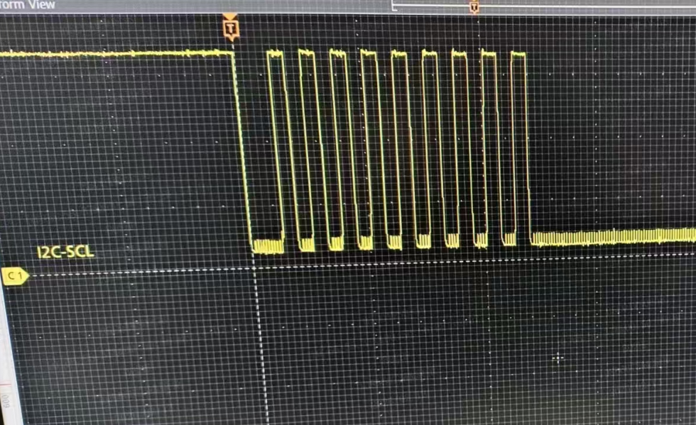

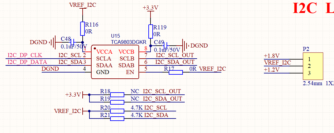

TCA9803: TCA9803 I2C Issue
Part Number: TCA9803
Other Parts Discussed in Thread: TCA9416, TCA9406, TS5A3160
We use TCA9803 to achieve I2C level shift from 3.3V(B side) to 1.2/1.8V(A side) ,however A side I2C waveform is abnormal,especially when there are fluctuations in the low-level state.Please help troubleshoot this issue,TKS.A SIDE DATA.pngB SIDE CLOCK.pngA SIDE CLOCK.pngSCH.pngB SIDE DATA.png
