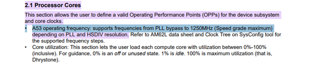

     5)Additionally , need the clarification regarding the below images
    Since this query is urgent, I would appreciate your clarification at the earliest.
    The device can operate a lower frequency, but it won't be supported by CPUFreq. Instead you'll need to do a register write. The clock tree tool will tell you which registers need to be modified and you can use devmem2 to interact with the register.
