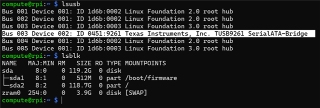

    Received the hardware and just finished testing and validation. Programmed the flash chip (MX25L1006EMI-10G) with the .bin firmware provided (No SATA or USB 3.0 flipping) and soldered it on the board after flashing with an FT232H USB to SPI converter.
    TUSB booted up in usb 3.0 mode and enumerated correctly. I was able to copy the RPI CM5 OS from SD card, can now boot up solely off of the sata ssd (ORICO 128GB M.2 2242 SATA SSD, Y20M-2242).
    Supervisor IC is correctly pulling the GRSTz low for 10ms after the (3.3V) SATA load switch activates (then releases to 3.3V pullup). SATA Load switch provides both 3.3V for m.2 SSD drive and TUSB 3V3 rail (I was concerned about them coming up at the same time as the eval module uses a gpio from the tusb to enable/disable the 5V rail on a non m.2 sata connector).

    Linux Detecting Bridge:
