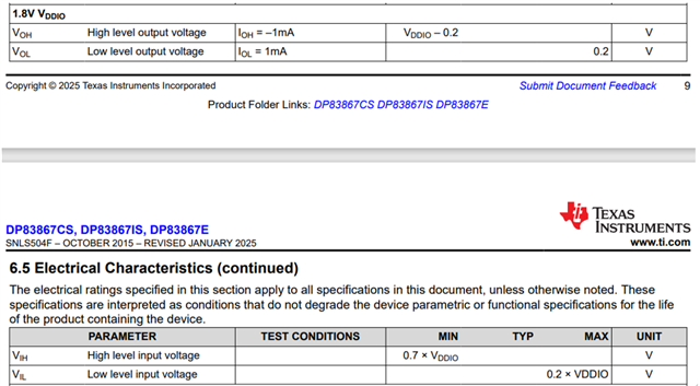

    I have another question.
    Regarding the RGMII specifications for the DP83867IS,
    is it LVCMOS? Or is it HSTL?
    Currently, VDDIO is set to +1.8V, so looking at VIH/VIL and VOH/VOL, it appears equivalent to LVCMOS.
    Output Levels
     VOH 1.6V or higher
        VOL 0.2V or less
    Input Levels (VIH/VIL)
     VIH 1.26V or higher
     VIL 0.36V or lower
    In the FPGA, I selected LVCMOS 1.8V and connected it via RGMII.
    ttd
  • Hi ttd,
    RGMII on DP83867 uses LVCMOS.
    J
