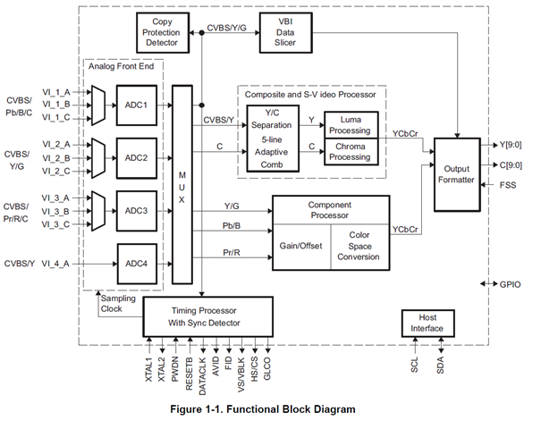

How to I bring in component video in to TVP5146?
and where does the output connects to (ie. TMS320DM368ZCE

As noted on the product folder page, there is no design support for the TVP5146M2.
However, looking at the collateral available, I have the following observations.
* The TVP5146M2 only supports YPbPr at 480i, 576i.
* There is useful information in TVP5146 FAQ application note.
* YPbPr connections are provided in figure 1-1 in the device datasheet
* As per the datasheet (and the EVM schematic, previously provided), the TVP5146M2 outputs the video data on the Y_[9:0] pins.
* The TVP5146M2 output data connects to the YIN[7:0] pins of the TMS320DM368. The EVM uses 8 bit mode and therefore does not connect Y_[1:0]. In addition, the EVM uses multiplexors to connect multiple sources to the TMS320DM368.
There are several application notes in the product webpage that may be of help to you. See https://www.ti.com/product/TVP5146M2
