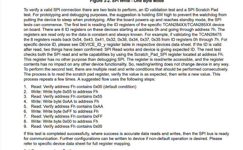

To validate the SPI write operation, I used the Scratch_Pad_SPI register and followed the same steps mentioned below.
However, after performing the write operation, when I read the Scratch_Pad_SPI register, it still returns 0x00. This suggests that the SPI write is not taking effect. I verified both the SPI read and SPI write frames using a Picoscope, and all frames appear to be correct.
1st FRAME: SPI READ  ADDRESS : 0x00 and EXPECTED Value : 0x54.
2nd FRAME : SPI READ ADDRESS: 0x0F and EXPECTED Value: 0x00.
3rd FRAME: SPI WRITE ADDRESS: 0x0F and DATA :0xAA.
4th FRAME: SPI READ ADDRESS: 0x0F and EXPECTED Value: 0xAA. (But I am getting 0x00, means SPI WRITE FAILED).

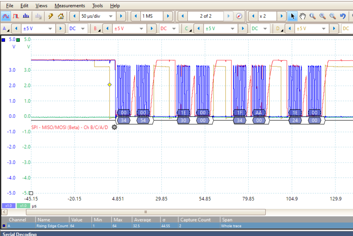

    Can you separate and label your SPI waveforms so I can see how you are sending them? Also, can you read the REV_ID from register 08h?

    SPI waveform:

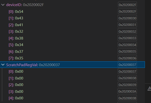

    Also, Please find the below REV data and INT data,
    Please let me know if any details required from my end.

    If the green curve is MISO (connected to the SDO pin of the SBC), then the waveform shows 0V continuously, so I'm not quite sure how you are able to read any register data. Can you elaborate on this?
    Also, if the red curve is MOSI (connected to the SDI pin of the SBC), it looks like there is a 4V spike in between the address byte and data byte of each transaction. That could be causing issues too. Is the MCU programmed to pull this pin high in between bytes like this? Also, what is the SCK frequency?
    Yes, that is correct. However, I was able to obtain the global interrupt data (0x34) even though the SDO line was at 0 V, as shown in the write frame screenshot above. Please refer to the another write frame below for further details.
    No. The MCU is configured in SPI 3-wire mode with manual CS pin toggling. It is not intentionally programmed to pull the MOSI pin high between bytes.

    I am able to read all the TCAN284xEVM register values successfully. However, I noticed that some register values are different from the default values mentioned in the datasheet. I read all the register values immediately after powering up the EVM and did not modify any of the default register values. Could you please confirm whether this behavior is expected?
    Register Reset Value Present Value
    DEVICE_ID Fixed 54 43 41 32 38 34 37 35
    REV_ID Device specific 0x21
    SPI_CONFIG 0x00 0xFF
    CRC_CNTL 0x00 0x00
    CRC_POLY_SET 0x00 0x00
    SBC_CONFIG 0x06 0xD7
    VREG_CONFIG1 0x00 0xFF
    SBC_CONFIG1 0x00 0xB9
    SCRATCH_PAD 0x00 0x00
