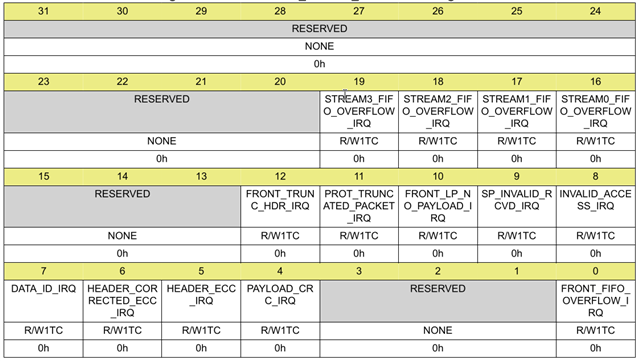

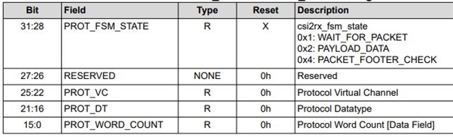

  • Hi Paul,
    This is good news. This could indicate some configuration issue. Can you let me know what the registers you changed do?
    Also, the error IRQ value indicates that there is some CRC and ECC errors being encountered:
    Please reply here if you need further help.
    Jay

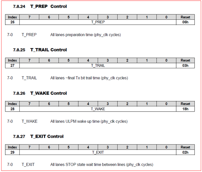

  • Hi Jay
    We are guided to configure/adjust below register, howeverwe may still face timing issue (log shows: A lot of buffers are being dropped.) between the decoder and MIPI Rx (TI AM62x_'s CSI2Rx)
    Register Default value TPI driver value MIPI standard timing value
    0x25 0x04 0x04 0x03(min)
    0x26 0x06 0x03 0x02(min)~0x05(max)
    0x27 0x03 0x09 0x08(min)
    0x28 0x18 0x18(default) 0x18(default)
    0x29 0x02 0x02 0x18(default)
    Some time (ramdonly) we could see a full image of real camera show out on LCD, sometime it split into two-part, or black green, etc as below:

  • Hi Jay
    The registers are about setting MIPI output timing from TP2855; Tx.
    i2cset -f -y 1 0x44 0x40 0x08 # select page (0x08 MIPI page), 0x44 is TP2855 address
    i2cset -f -y 1 0x44 0x25 0x03
    i2cset -f -y 1 0x44 0x26 0x02
    i2cset -f -y 1 0x44 0x27 0x08
    i2cset -f -y 1 0x44 0x28 0x18
    i2cset -f -y 1 0x44 0x29 0x18
    Our latest test, we try to set the given MIPI standard timing value but still failed; only green/black screen shows out.
    We are suggested to check/adjust the same timing for both Tx and Rx (AM62x).
    Any registers that we can set or read out to confirm those timing of AM62x? Or any suggestion, please let me know. Thanks.

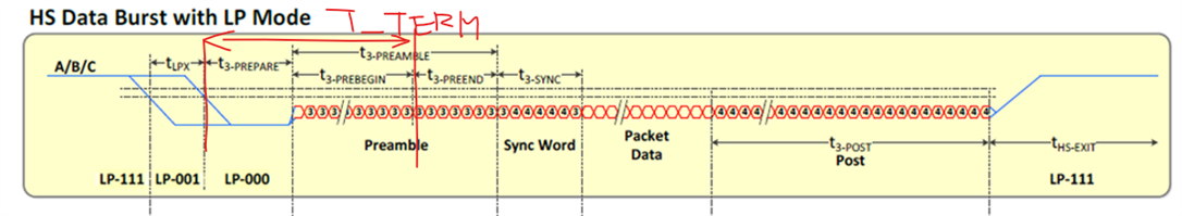

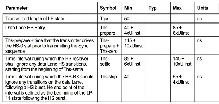

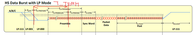

    "Regarding MIPI timing in the MIPI RX (AP), you will be able to adjust the T_TERM value as follows.
    Generally, you can adjust the prepare timing regarding MIPI timing between MIPI TX and MIPI RX.
    If you look below for the AP MIPI RX, it appears that you can adjust the (T3-PREPARE + T3-PREBEGIN value  = T_TERM)."

  • Hi Paul,
    Please advise what the DPHY-TX side is configured to for the below parameters. I would like to confirm these are as per MIPI and fall within conformant values of the DPHY-RX side (AM62x).
    • TLPX
    • THS-PREPARE
    • THS-ZERO
    Luis Parga
  • Hi Luis & Jay
    1. Below is the paremeters of DPHY-TX decoder side (HS Transmitter AC Characteristic)
    2. The current symptom remains the same as reported in our previous comment dated April 8th.

    Aren't TLPX, THS-PREPARE, and THS-PREPARE + THS-ZERO programmable for the TPS2855? If so, what are these specifically programmed to? Have you tried other link frequencies? You can try for example a link frequency of 800MHz (data rate of 1.6Gbps), but we need to make sure both the TX and RX side are set to the same link frequency. Also, when the data rate is greater or equal to 1.5Gbps, we need to ensure the TX side is sending an initial deskew calibration pattern. Please note that AM62x does not support periodic deskew calibration; only initial deskew cal is supported by our DPHY.

  • Hello Luis,
    Yes, they are programmable by adjusting the register values (0x25–0x29) via i2c command, as mentioned in my previous comment on April 2nd. We will provide more detailed information and adjustment guidelines for the TP2855 as below.
    Default Tx setting values:
    TP2855 MIPI Tx timing control regsiter:
    First, could you please check whether the current (default) TX timing configuration matches the RX's?
    Below are the Tx timing values provided by the decoder vendor when using the following register settings: Reg 0x25 = 3, Reg 0x26 = 2, and Reg 0x27 = 8. We can use these as a baseline for further adjustment.
    It may be better to adjust only one side (e.g., RX), while keeping the other side fixed to ensure proper alignment.

    1)This is the MIPI standard timing. Please refer to the red box.
    2) Regarding to this issue, a suggestion to adjust MIPI timing in the MIPI RX (AP-AM62) is the T_TERM value which the prepare timing. Any comment, please let's know. Thank you.
    T3-PREPARE + T3-PREBEGIN value = T_TERM.

    Can you provide scope captures on the RX side? Also, the below registers should be in general good to use for debugging this issue.
    CSIRX_ERROR_DEBUG 3010 1074h
     DL0 to DL3 : 3011 0C18, 3011 0C24, 3011 0C34, 3011 0C40
    CSIRX_INTEGRATION_DEBUG 3010 1060h
    CSIRX_STREAM0_MONITOR_FRAME 3010 1114h
    Hi Jay,
    Can you help to provide working driver that Paul can use as a reference?
    Luis Parga
  • Hi Luis,
    Below is scope capture.If something is wrong, please provide guideline.
    The regsiters are captured during a Camera streaming.
    1) CSIRX_ERROR_DEBUG 3010 1074h
    root@am62xx-evm:~# devmem2 0x30101074 w
    /dev/mem opened.
    Memory mapped at address 0xffff9d045000.
    Read at address 0x30101074 (0xffff9d045074): 0x8012005E

    3) CSIRX_INTEGRATION_DEBUG 3010 1060h
    root@am62xx-evm:~# devmem2 0x30101060 w
    /dev/mem opened.
    Memory mapped at address 0xffffb0e38000.
    Read at address 0x30101060 (0xffffb0e38060): 0x20000000
