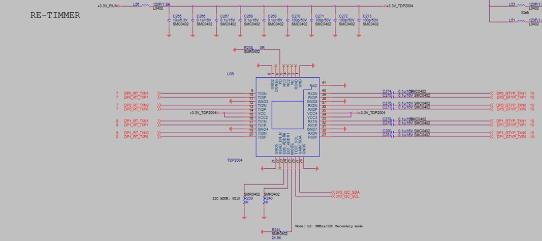

Our design utilizes 2 DisplayPorts (DP), with each DP using only 2 lanes. Can these 4 channels be divided into 2 independent groups (2 lanes per group)?
  1. Can these two groups be enabled or disabled independently?
  2. Can these two groups be configured with different Equalization (EQ) settings?
Please help review the circuit/schematic.

    Here is the schematic. Thanks!
  • Jeff
    On the schematic review
    1. Please make sure both input and output main link are AC coupled with 0.22uF, size 201 capacitors
    2. Please make sure the I2C bus has pullup resistors on them

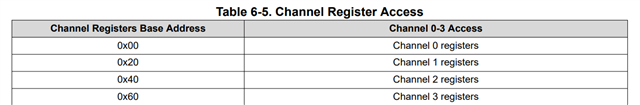

    Yes, in I2C secondary mode, channel register base address 0x00 -> Channel 0, 0x20 -> Channel 1, 0x40 -> Channel 2, 0x60 -> Channel 3.
    For channel enable or disable, this is done through register 0x05
    For EQ configuration, this is then done through register 0x01 and 0x03
