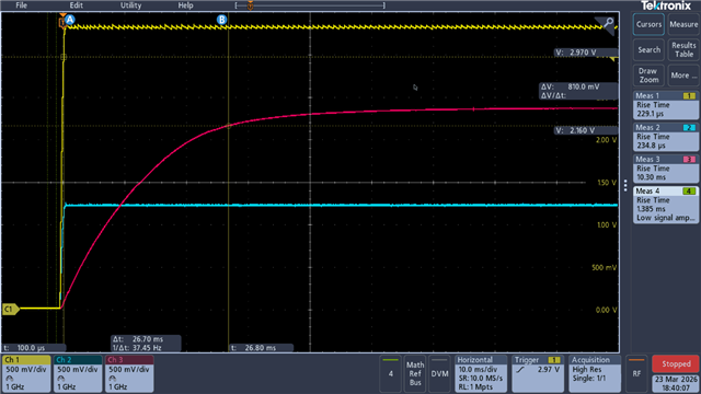

    Since the problem was reproduced in the automated testing, I checked the following:
    -VDD, VCC, and OE are no problem.
    -The problem was recovered after OE was set to Low, then to High, and input signal was removed and reinserted.
    -Intentionally, OE set to High before Power-up sequence, the frequency of occurrence has increased. (3/378 times)
    -Removed U1204, and added 0.1uF, the frequency of occurrence has decreased. (0/2683 times)
    It seems like the problem is close to being resolved, but I still don't understand the root cause.
    I checked Power-up sequence after removing U1204 and adding 0.1uF. (See attached image, Yellow: VCC/Blue: VDD/Red: OE)
    I would appreciate the following questions:
    1. OE doesn't meet td2, but is this unrelated if OE isn't controlled?
    2. Power-up sequence appears the same as U1204, but is something changing internally? (OE rises simultaneously with 3.3V and before 1.2V.)
    Thank you and best regards,
    Nagi
  • Hi Amano-san,
    1. We recommend to use larger capacitor to ensure that the ramp time for OE pin is slower and meets the datasheet requirements.
    2. It may be possible that the device’s digital block was backpowered from the OE pin had the blip and put the device into a bad state. We have never characterized device for those kinds of situation so we cannot be sure however.
    J
  • J,
    Thanks for your reply, and I made a mistake.
    The above board may have been damaged during automated testing.
    I checked Power-up sequence after removing U1204 and adding 0.1uF on a different board. (See attached image, Yellow: VCC/Blue: VDD/Red: OE)
    I will try automated testing on a different board.
    -OE is around 2.4V, is it no problem?
    Nagi
  • Hi Amano-san,
    Are you still seeing display when OE pin is 2.4V? The datasheet does specify that 2.6V is the minimum for VIH of OE pin. However, this value is when the microcontroller drove logic high/low. When the RC circuit is used to drive the OE pin, we expect that the OE pin may not rise above 2.6V but the device will still function properly.
    J
  • J.
    I found the following similar questions:
    -TMDS181: Internal Threshold for OE Pin When Using Capacitor - Interface forum - Interface - TI E2E support forums
    td2 is too long with 0.1uF, so I'd like to consider a smaller value.
    Therefore, I'd like to know how to measure td2. (90% of VCC 3.3V -> 90% of OE 2.4V?)
    Nagi
  • Hi Amano-san,
    Yes, your understanding is correct on the below measurement setup.
    J
